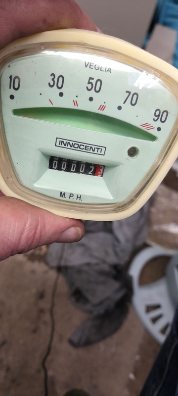

I've got a load of 12v LEDs which fit in a speedo nicely if you're happy drilling your speedo face. Pretty subtle. You can have one for nowt.
Re: CamLam fuel light
PostPosted: Fri Jan 14, 2022 11:00 pm
by dickie
Looks like this

If I buy one, I doubt I’ll start drilling an original GP Speedo, especially as it works okay still :) but thanks for the offer, Dickie.

No, I wouldn't drill an original speedo. Both my s2 and s3 have original speedos, so as much as I'd like to, I can't bring myself to do it.
