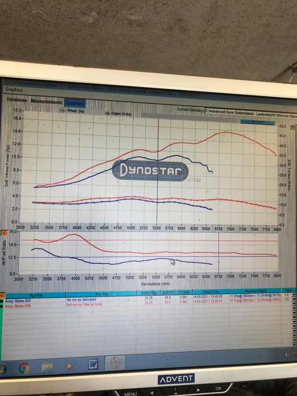

First up my TV. RT195, standard crank, 25 PHBL, GP modified airbox with the internal baffle removed, BGM mk 4 exhaust
Dyno result below where Al took an as delivered base line (blue line) and 2nd run with the air filter hose removed, carb run open mouth, (red line)
I was surprised how restricted a standard GP air box was with the baffle removed!

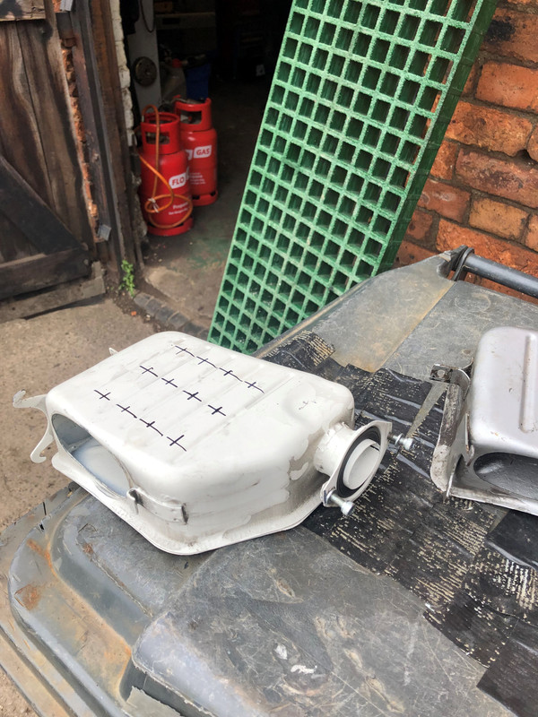

Air box was then modified with a 12 mm drill, per the below
this then de-ristricted the airbox allowing more air, and releasing more performance. see graph below comparing to a GT kit

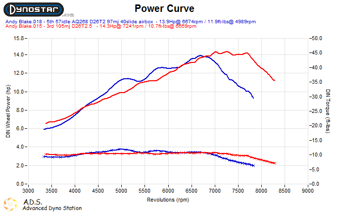

Here's a graph comparing both RT and GT kits
Red line = GT186 (chris sturgess modified), 25mm PHBL, Scootopia Exhaust, big bore airbox
Blue Line - RT195, 25mm PHBL, BGM Mk4, Heavily modified GP airbox
I'll let you draw your own conclusions ;)

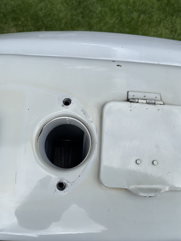

Any photos of the airbox from Scooter Restorations , dimensions etc?
Sure thing Bruce ;)
Looks all standard, but the difference is under the air scoop and hidden. The air intake is a whopping 49mm internal diameter on the big box versus 37mm for a standard SX!
I've posted a couple of images so you get the idea
