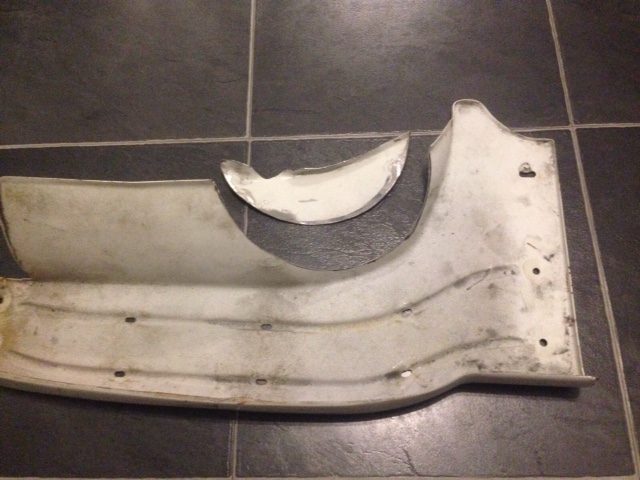

Postby Norrie Bodge » Sun Feb 23, 2020 11:00 pm
shane BBoys wrote:I have a question, how is it that a series 2 differs from a series 3? I understand about panel clearance but is the bracket that fits to the engine casing not the same, is the hanger on the tale pipe any different?
Confused Shane.
Is it a JL3?
I add to modify the left side rear board too when the downpipe sweeps up!
I’ll see if I can find the photos of this

Postby Norrie Bodge » Tue Feb 25, 2020 7:28 am
shane BBoys wrote:Thanks Norrie that would be great.
Cheers Shane
here you go mate.
i had to cut a half moon out, then turn it upside down & weld it back in for my JL3 to miss the footboard.
