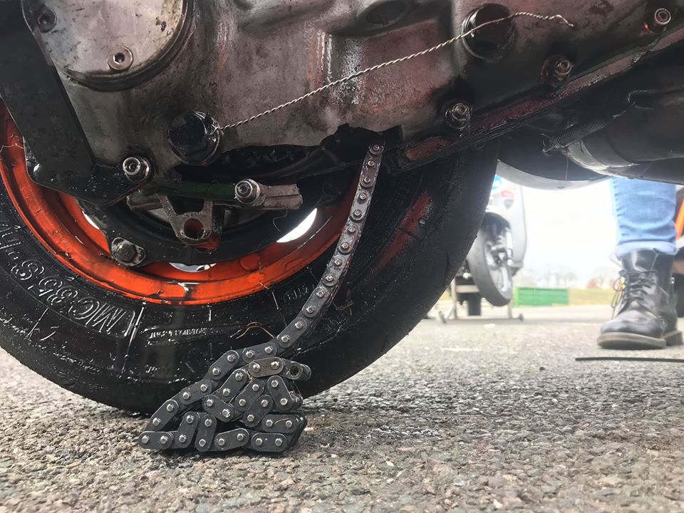

Postby dscscotty » Fri May 08, 2020 2:13 pm
I've never witnessed a chain fail using connecting links either.
I have, a few times with half links, with devastating results this was an 83 pitch Regina,in a TV200 Casing,Mallory Park flat-out in 4th round Gerards! :shock:
I've also had an Iwis let go on my road bike, the type with the black half link snap on route back from Kelso rally, also know of several other Iwis with black links snapping.

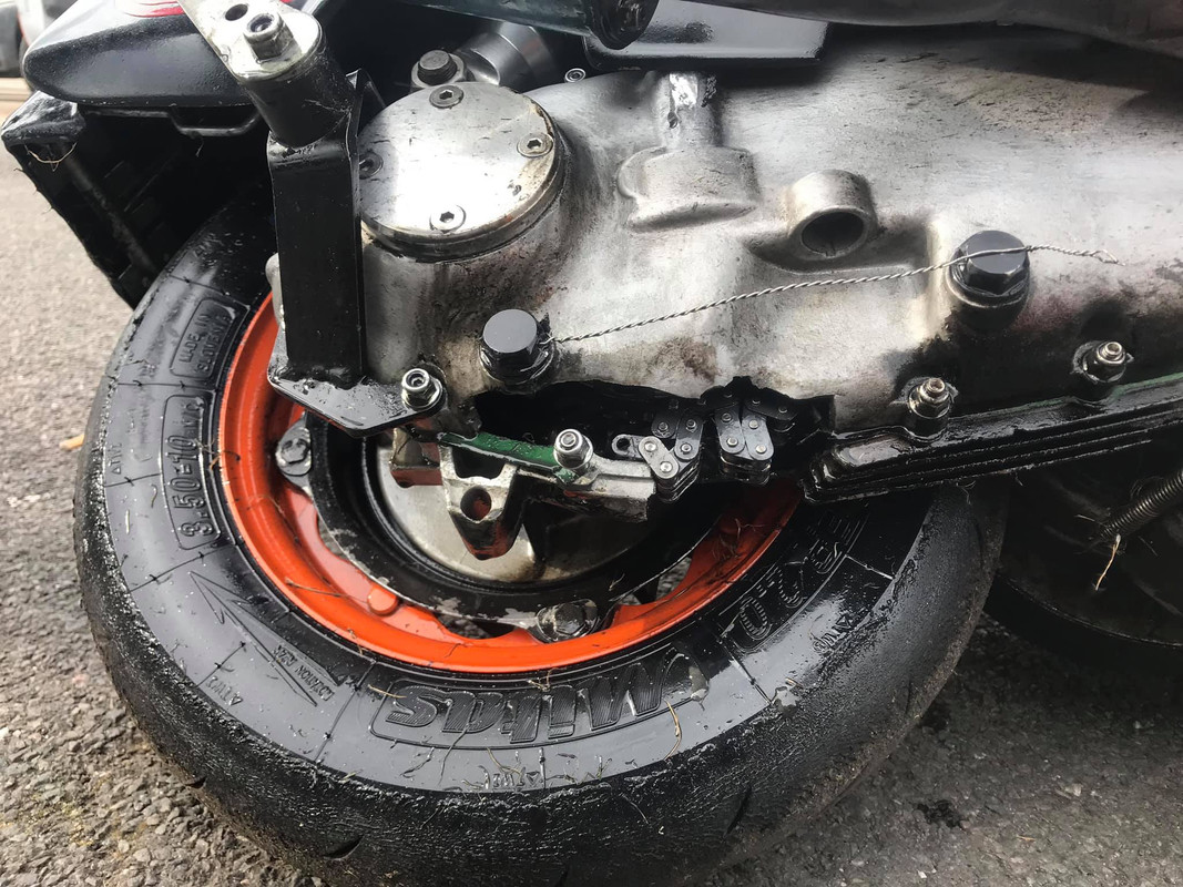

Apologies to the original poster for going off topic, just a note that we use Casa chain guides in our race scooters, great bit of kit, just a word of caution use loctite when fitting,

Postby bsso78 » Tue May 12, 2020 2:22 pm
I snapped a half link chain in my production class motor after 2 miles. Half a mile was seeing what the jetting was like straight out of the box, which was horribly rich then half a mile home. The other mile was after I had rejetted it properly and give it a good handful. It snapped and wrapped around the front sprocket twisting the crank. I then had to push it home.
I hate scooters.

Re: Casa Chain Tensioner
Postby Warkton Tornado No.1 » Tue May 12, 2020 2:46 pm
bsso78 wrote:I snapped a half link chain in my production class motor after 2 miles. Half a mile was seeing what the jetting was like straight out of the box, which was horribly rich then half a mile home. The other mile was after I had rejetted it properly and give it a good handful. It snapped and wrapped around the front sprocket twisting the crank. I then had to push it home.
I hate scooters.
Was the link branded in any way? Many of them aren't, in which case, they might just as well be made from old Blakeys or Segs. Or worse.....rejected Rolon chains :roll:
There's no reason as to why a cranked link or correctly fitted connecting links should have any tendency to fail, but should be fitted 'trailing' not 'leading' IMHO & I also prefer 'one-&-a-half' links rather than 'half' links. Duplex chains are an absolutely excellent concept, rarely failing in other uses, such as camshaft drives, where they are often fitted for life, by comparison with timing belts. Accurate sprocket alignment is essential though. Not as in any Lambretta manual, but as good as you can get.
