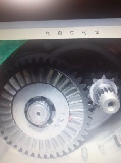

Postby dscscotty » Mon Apr 13, 2020 10:03 am
Hi Scott, regarding your concerns around end plate being warped, I doubt very much this is the issue, the reason the exchange of end plate appeared to be better will more likely be down to the wear on the end plate. With regards to AF close 5's the advice on the instructions as you say states 1.4 to 2mm, however you can only work to the clearances you have, many factors contribute to that, from the casings used, choice of rear hub bearing, layshaft and and plate, including the wear on the end plate boss. Also double check the shims dimensions as I've found on many occasion that they can be in correct, a few thou difference can make a difference. I've fitted many AF 5 and cyclones 5 speeds in both road and race engines, with shims varying from 0.8 to 2.2mm, one in finishind runner up in the LCGB BSM championship 2 yrs in a row is fitted with a 1mm shim, the gearbox, shims etc all in excellent condition, the real secret to 5 speeds is ensuring the 5th loose gear and the 5th on the cluster are in perfect alignment, place 5th in situ, along with cluster, tighten end plate and draw cluster out to its fixed position, and hold the loose cog down with your fingers so its seated correctly on the layshaft. You will need to drill hole in your end plate, to see this, adjust the cluster height accordingly with shims on top of cluster, AF dont supply these, however MB do crank spacing shims that will fit, do not shim beneath the cluster as that needs to be as open as possible to allow for good lubrication, dont worry about the needle bearing moving its not an issue, the main foucus should be getting the 5th in perfect alignment, then look at layshaft/gear stack shimming. here's some pics of one I fitted this wk=eek, notice the extra hole drilled evn on the casa endplate to ensure I was able to check 5th gear alignment,
Good Luck and Stay safe!
ps I'll add some pic later
Re: warped endplate
Postby dscscotty » Mon Apr 13, 2020 2:15 pm
Apologies for poor quality pics, me laptops playing up
Imagefree pic host
