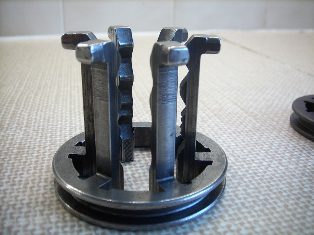

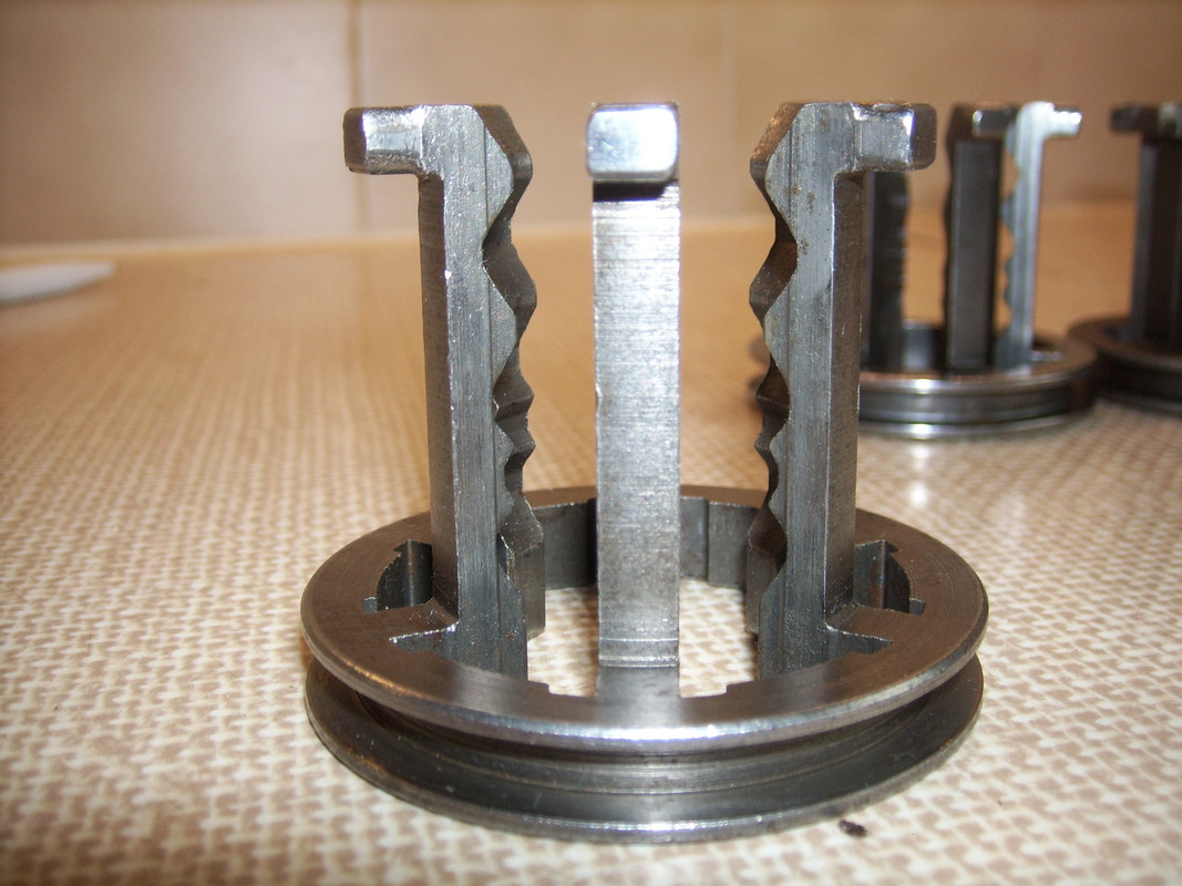

Not wanting to hijack someone else's thread- I thought it would be proper to put up my own. A couple of pictures of some sliding dogs I own, one OEM Innocenti , the other has no markings but its good quality . Now I've looked at the picture of the sliding dog in sticky's manual and both mine are more worn than the one pictured but surely they can be used- as is? reground square? or material added? here's the piccies
OEM innocenti one
the unmarked one
The width of the OEM on the legs is about 6.5mm and 7mm on the other, thanks Paul

Judging the images, I would be prepared to machine them back for re-use. If I were you that is. I'm not volunteering :?
My current rides are probably 25 BHP minimum & 'torquey' & they have had no cursor issues.
As already mentioned, all six dogs need to be identical, so just take off the minimum of just the driving faces.
I was thinking about how the process could be made easier, & I suppose if the cursors were centralised & held static in a lathe with an indexing system, a grinder (or electric file!) could be affixed to the lathe saddle/cross-slide to obtain consistent results

Ha! :) yeah that seems to be the case WT ;) I'm interested in giving it a go myself but as I'm only armed with a dremmel and a pretty decent set of needle files - my main concern is as you state , is getting each face identical , hmmm.... something to think about , thanks for the reply . Paul

You'll struggle against them with needle files i think. They are very hard.

Yeah I can imagine , they would only be any good for cleaning up the surfaces
