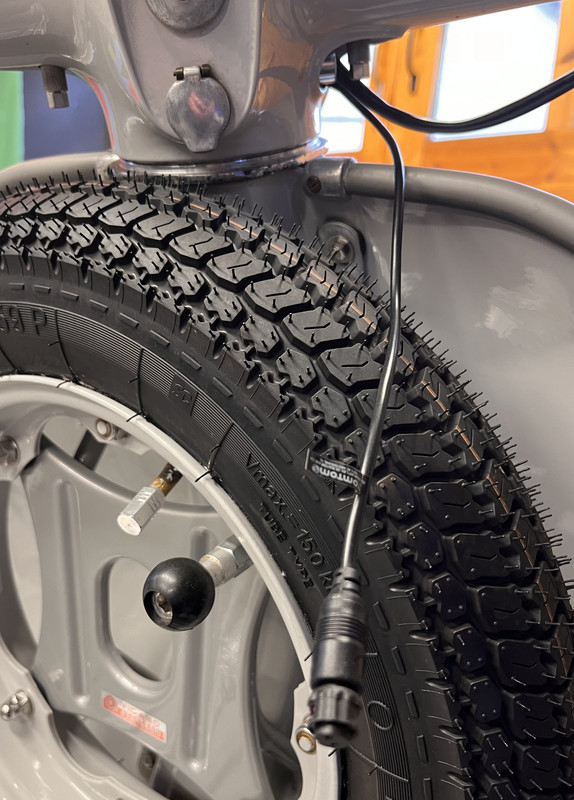

I've decided to drill a 10mm hole in the legshields behind the horn-casing to allow the power cable for the satnav to exit via a grommet
The cable exit will be obscured by a spare wheel holder to a certain degree

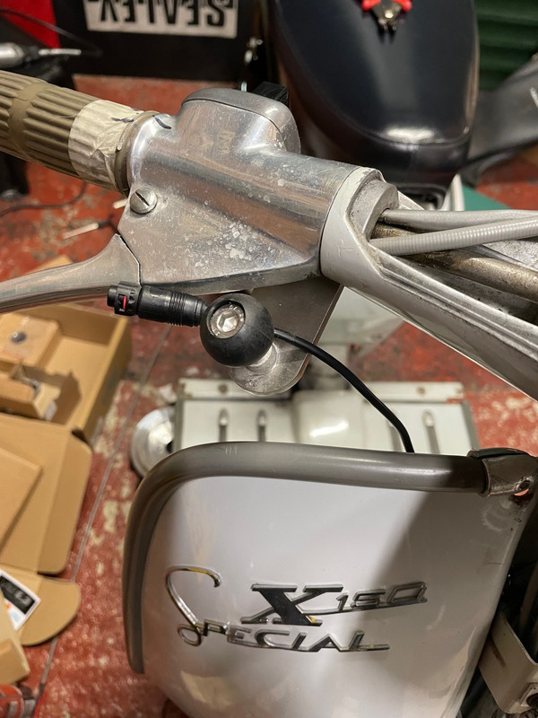

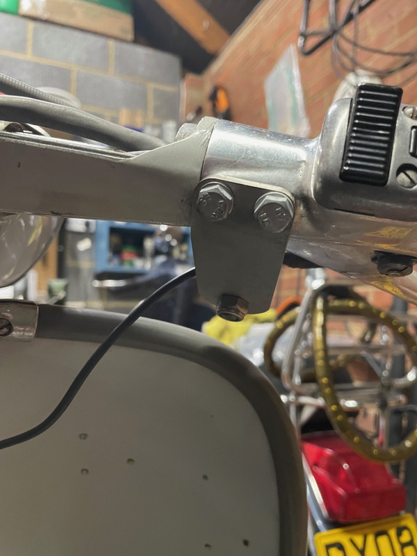

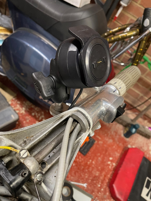

Here's a couple of pictures of the satnav mount I'm using
The power cable connects to a TomTom Rider quick release mount this this
You can get a security device to save the satnav getting pinched when you're away from your scoot paying for petrol etc..

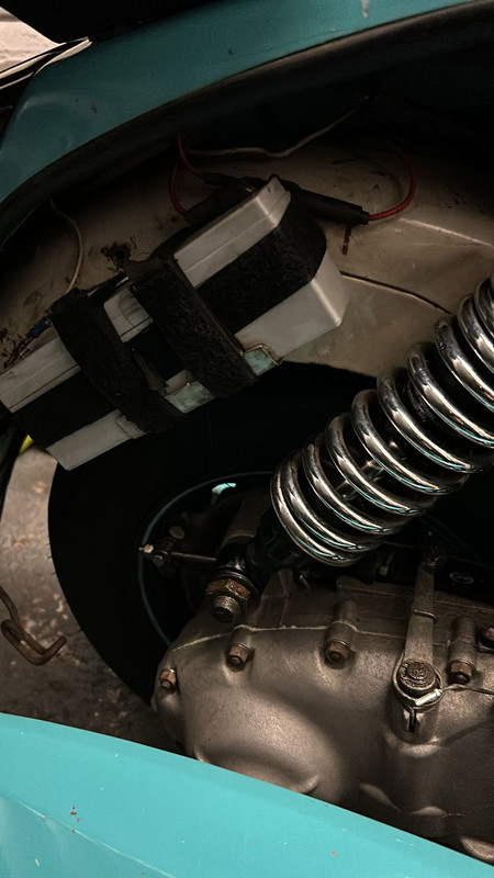

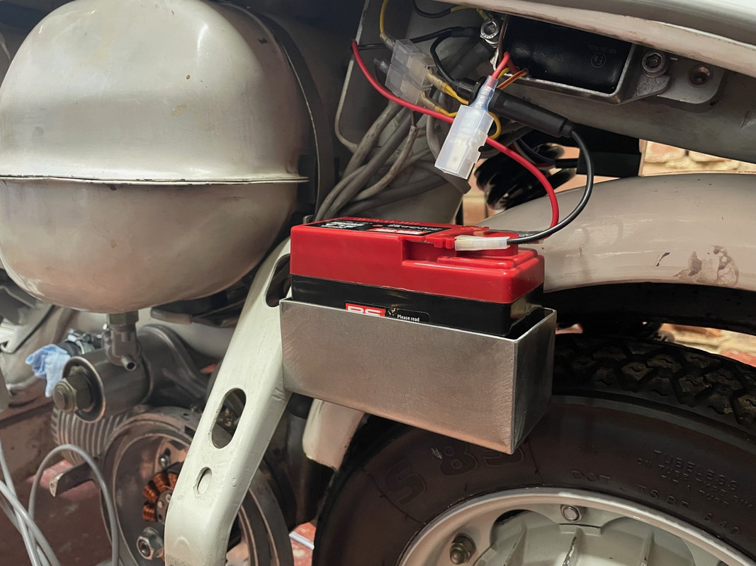

I was originally planning on using a DC trickle feed off the regulator to power/charge the satnav internal battery. However for fear of damaging the satnav at low revs when voltage fluctuates up and down I've decided to use a small battery using the DC trickle feed to top up the battery whilst the battery provides a stable voltage to the satnav.
Cambridge Lambretta do a small battery tray which mounts to the left hand rear runner leg using existing holes
Here's the battery powering the satnav so you can see the size and fitting
The regulator is not connected in this picture and the fuse is on the negative leg the same as my GP200. I have since changed the fuse to the positive side of the battery.
My plan is to use a three way connector same as this to connect the regulator DC output to the battery +ve and the satnav

Neat idea & was thinking of a similar set up with a Li Ion battery and my existing tray unit..

I dont want to hijack this thread but this might be of use. I set up a battery to run indicators and a rear view cam. The battery was charged off a regulator with the extra terminals for a battery. Things went ok until after a ride the battery was down to 10 volts, although everything ran with the engine running. I plugged the battery in to my charger which said it was defective. this was after its first run out. Any ideas ?

Postby nsaints » Wed Oct 23, 2024 7:10 am
Here are some general suggestions
Check integrity of you wiring - check for loose connections, poorly made crimps. Pay lots of attention to your earth connections
Battery maybe defective - swap for a known good battery
Don't assume your battery charger is working correctly - I had a number of issues with battery's running flat prematurely, with associated head scratching. Once I invested in a good quality battery charger the issues went away. If you’re after a suggestion I recommend a CTEK MXS 5.0 which can look after batteries from my VW camper, the Wife's Vespa, to the small battery I'm using in this application
The CTEK can recondition older batteries and resurrect “dead” batteries that have been overly discharged.
Good luck!

jonno wrote:I dont want to hijack this thread but this might be of use. I set up a battery to run indicators and a rear view cam. The battery was charged off a regulator with the extra terminals for a battery. Things went ok until after a ride the battery was down to 10 volts, although everything ran with the engine running. I plugged the battery in to my charger which said it was defective. this was after its first run out. Any ideas ?
What was the voltage across the battery terminals with the motor running?

Postby jonno » Sat Oct 26, 2024 3:56 pm
It was a new battery, and was charging when running. I'm beginning to thing the cam pulling more than I thought it would, and the charging isn't enough, though everything worked with the engine running and the battery was 10v after I switched off the engine.
