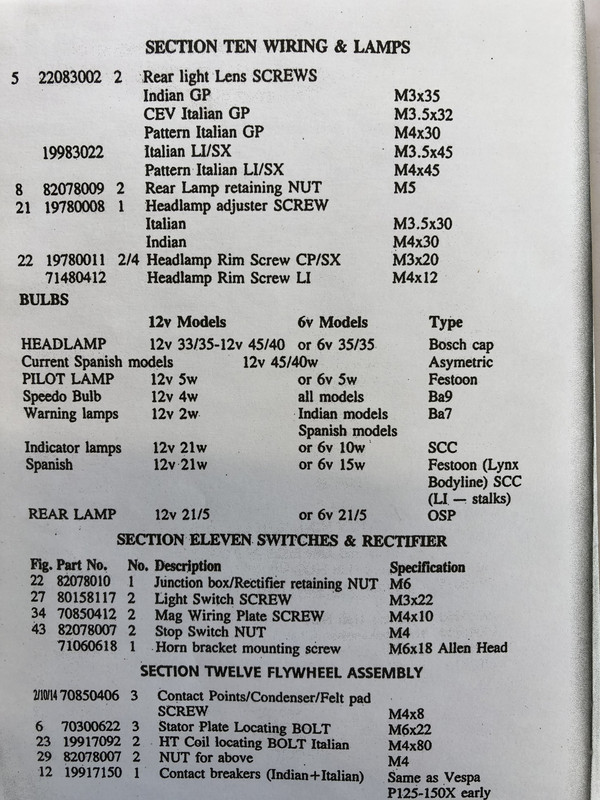

Hello there, if anyone could tell me the tap size for the two screws which hold the light rim on a LI series 3 headset top - that would be smashing :) many thanks Paul

3.3mm i believe.

Postby Storkfoot » Tue Dec 03, 2024 10:07 pm
From memory, they are the standard pitch.
Re: Tap Size for LI3 headlight rim screws
Postby Scooterslag » Tue Dec 03, 2024 10:23 pm
Storkfoot wrote:Image
Cheers for that- Paul ;)

M4 Tap & 3.3mm tapping drill.
