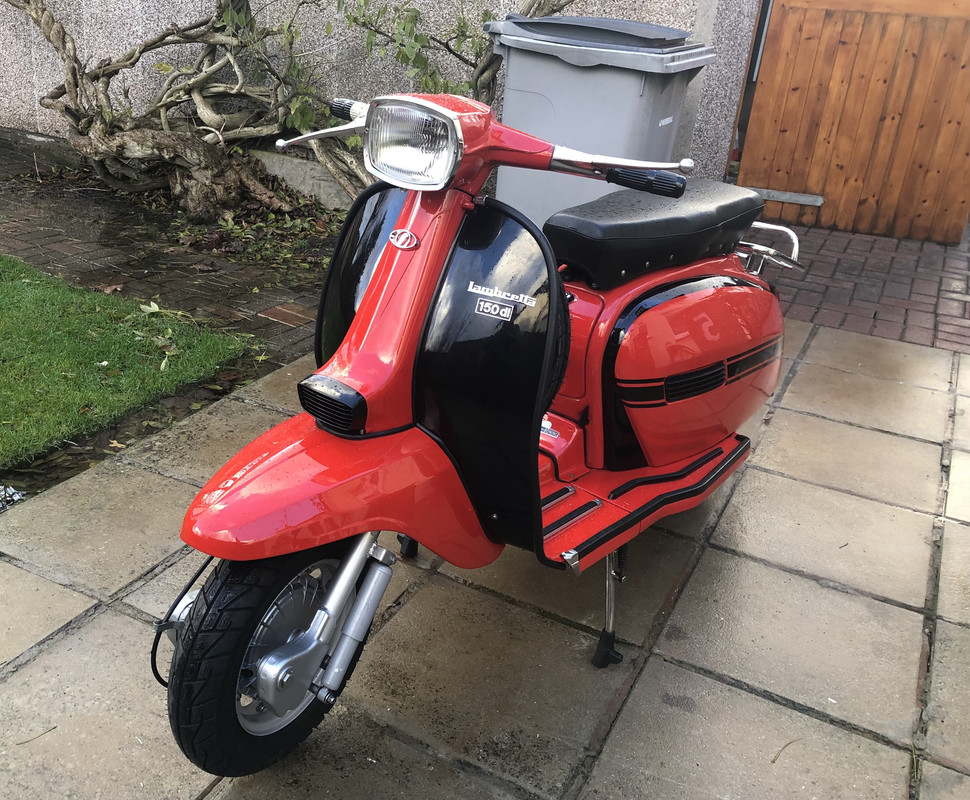

I know it’s almost impossible to tell from photos and it also matters what colour undercoat is used but:
Posts: 2543
Re: Martian red.
Postby Adam_Winstone » Sat Mar 15, 2025 11:15 pm
Yep, Humberside Paints sprayed test cards with different primer colours (wht, yellow, red oxide and grey) and then numbers of coats too.
They settled on grey primer, a certain number of coats and their own formular, which ended up being a very good match. A change to any of these factors would throw out the final match.
