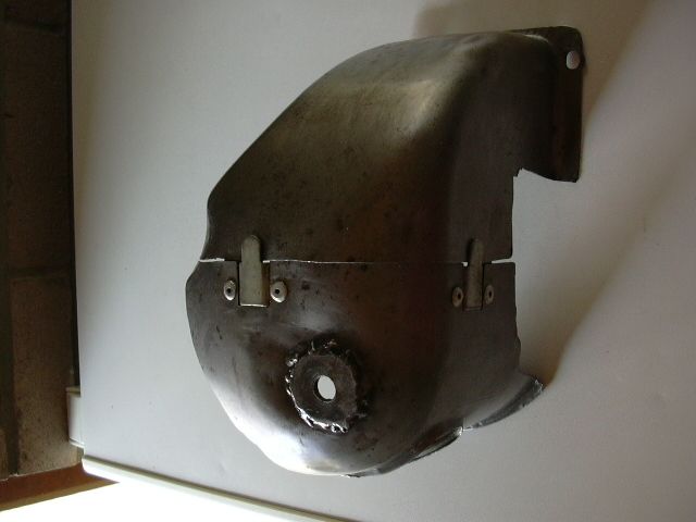

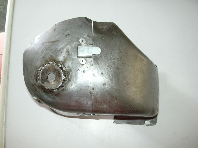

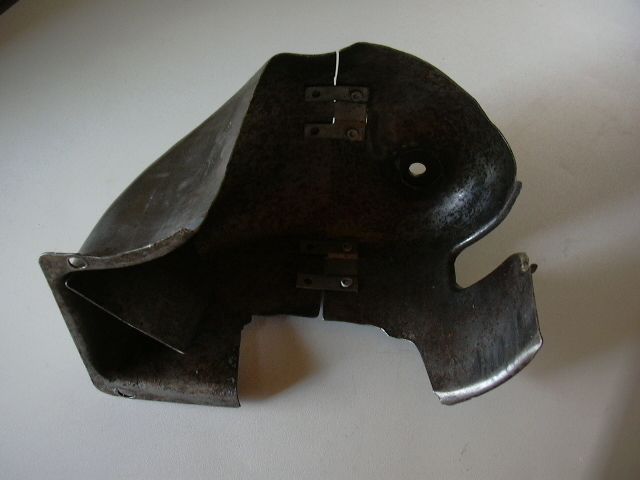

Postby jonno » Tue Jul 07, 2015 9:22 pm
This is one I did for my sprinter,yes with a bit missing.Could be cut horizontally with mag and cylinder bolt holding bottom section,mag and some sort of fixing holding the top in place.As you can see the cowl distorts when cut,so perhaps some sort of channel,H section could be made up along the cut.Or perhaps interlocking pieces could be spot welded on,and joined like the toolbox ?
