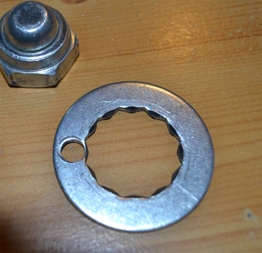

I am putting the error down to a well worn hub and the locking screw coming loose - the former being an eventuality and the locking screw my fault - after a full rebuild I should have checked it. I probably ran a good 4 KM after the problem bloomed fully, trying to get back to my garage with a wobbly hub (though not recognising the symptoms at the time), which might explain the damage.
The locking locking ring is totally shot - a cheap replacement that I will think twice about next time. Image
I have 'upgraded' to an MB stainless steel version. Which is a hat above the previous one, it's thicker, solid, fits over the nut well and binds much better.
Even with good torque on the cone, if the locking screw comes loose, and I'm braking, it's going to come loose I guess. I had 450 klicks of constant back road stop/start before it failed.
