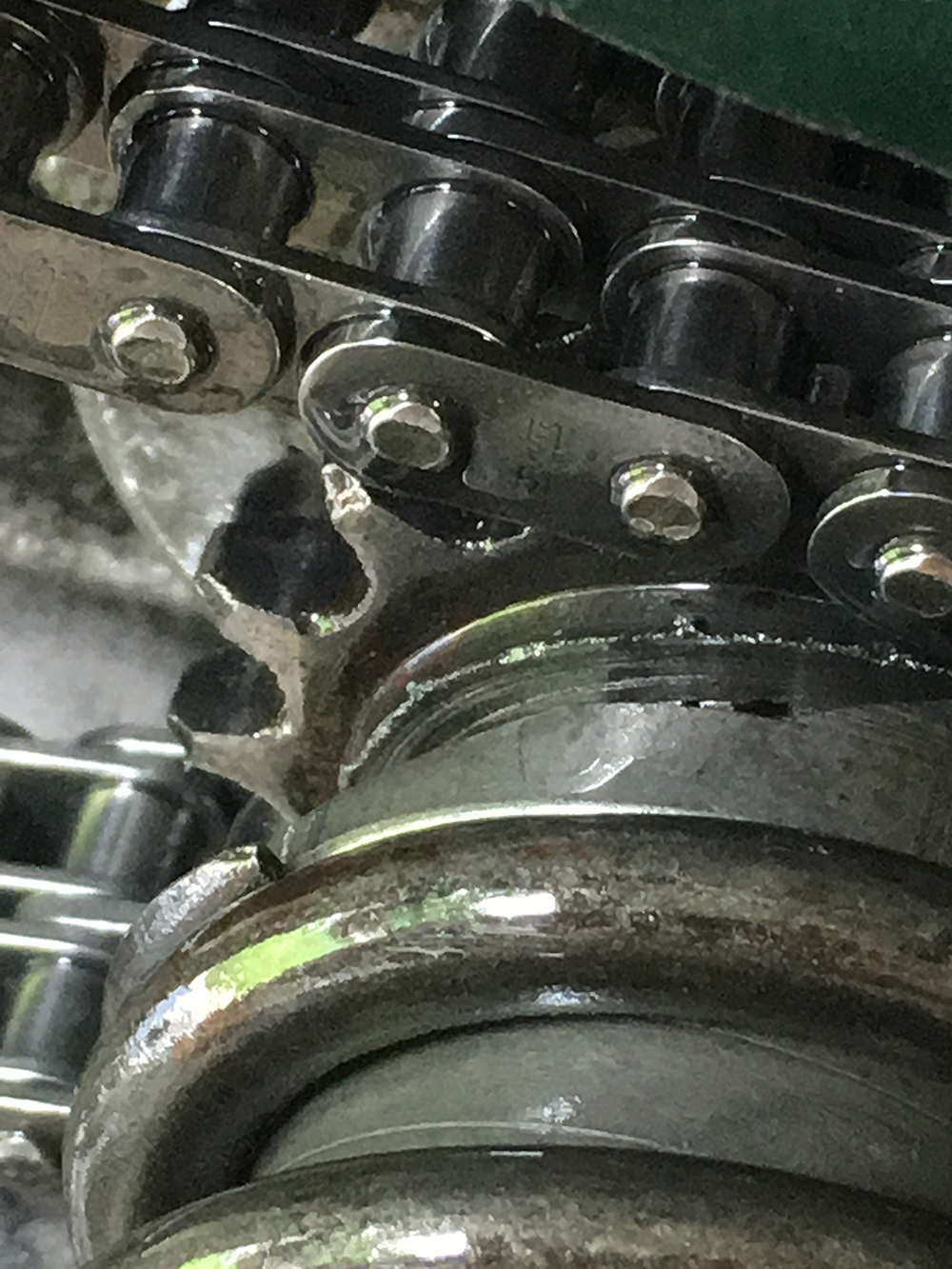

But yep all the rest including the thimble were spot on, then I followed the same train of thought as yourself, ie what else in the drive trains a possibility and led me to this
on running my finger on the edge it's sharp as a knife so definitely appears to be the front sprocket / cush drive.
I'll get that stripped and see if i have a replacement, pretty sure it's that and thanks for the reply :-) it's always good to sound these things out with fellow scooterists.

Postby Donnie » Fri Jul 22, 2016 4:15 pm
Hmmmm spot the difference :!: :shock: :shock: :evil:

Postby Adam_Winstone » Fri Jul 22, 2016 4:41 pm
This is the sensation of clutch slip that often gets me talking about front sprocket assemblies and the ramps riding one over the other... you now know the sensation and can see why so many people think that this is a clutch issue.
Whilst yours is a terrible example (or wonderful as examples go) of soft sprocket wear, this can also happen if you fit a SI spring by accident, if the sprocket has been machined too low or if the assembly is simply worn.
This photo may help others think about the issue whilst trying to think through the sensation of clutch slip that they suffer.
Adam

Postby Donnie » Fri Jul 22, 2016 5:12 pm
exactly adam, and exactly why i took the photo for reference for others when they use the search function.

Postby johnnyXS » Sat Jul 23, 2016 8:26 am
blimey that sprocket is soft as butter to wear like that.! No prizes for guessing where it was manufactured. :D
looks like the metal hasn't been tempered correctly.... if at all.
I guess it probably started due to insufficient spring tension coupled with a powerful engine and aggressive throttle :lol: Was the spring new ?

Postby johnnyXS » Sat Jul 23, 2016 8:58 am
Donnie wrote:Not new but good. all innocenti and no marks on the other cush parts or sleeve at all.
mmm call me a cynic but I'm surprised at the wear pattern on that part if it was properly tempered steel. The fact that there wasn't corresponding level of wear on the opposing part speaks volumes. ;)
I suspect there are many pattern parts being cast in the Far East with Innocenti markings . Outwardly there is no way to tell really except for the poor casting and finishing.
Same as clothes ....when was the last time you were sure you had bought some pucker levi 501s ;)

Postby bazza3004 » Sat Jul 23, 2016 7:02 pm
Donnie wrote:Hmmmm spot the difference :!: :shock: :shock: :evil:
Is it a camera angle thing or are the two sets of teeth all to cock as well . They look closer together on one side than the other.

Postby a.lo » Sun Jul 24, 2016 7:41 pm
the flat end don't look to clever either

Postby Donnie » Mon Jul 25, 2016 11:45 am
Yeah the flat end was well worn too, so theres no way this was hardened, as for it having innocenti markings it didnt, its aftermarket but obviously a shoddy one.
when i looked at it again one of the teeth was cracked and with a small squeeze i was able to dislodge it completely falling off in my hand!
as for the teeth rows being together on one side, thats the close up of the camera distorting the picture, ive checked :D
