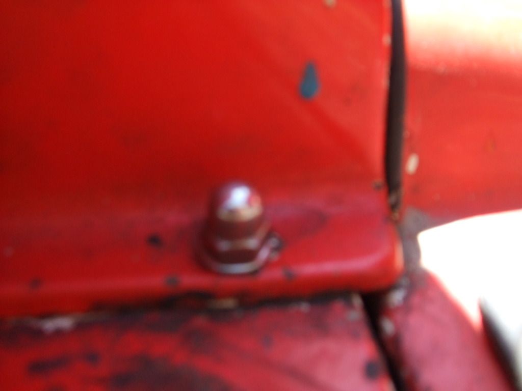

I used these with pop-rivets to secure them in place:
Remembering now that I found that M5 Rawl nuts that I have were also a bit big for the slots in my frame so I had to enlarge the slots to a shape like a key hole to accommodate them in what I judged to be the best place.

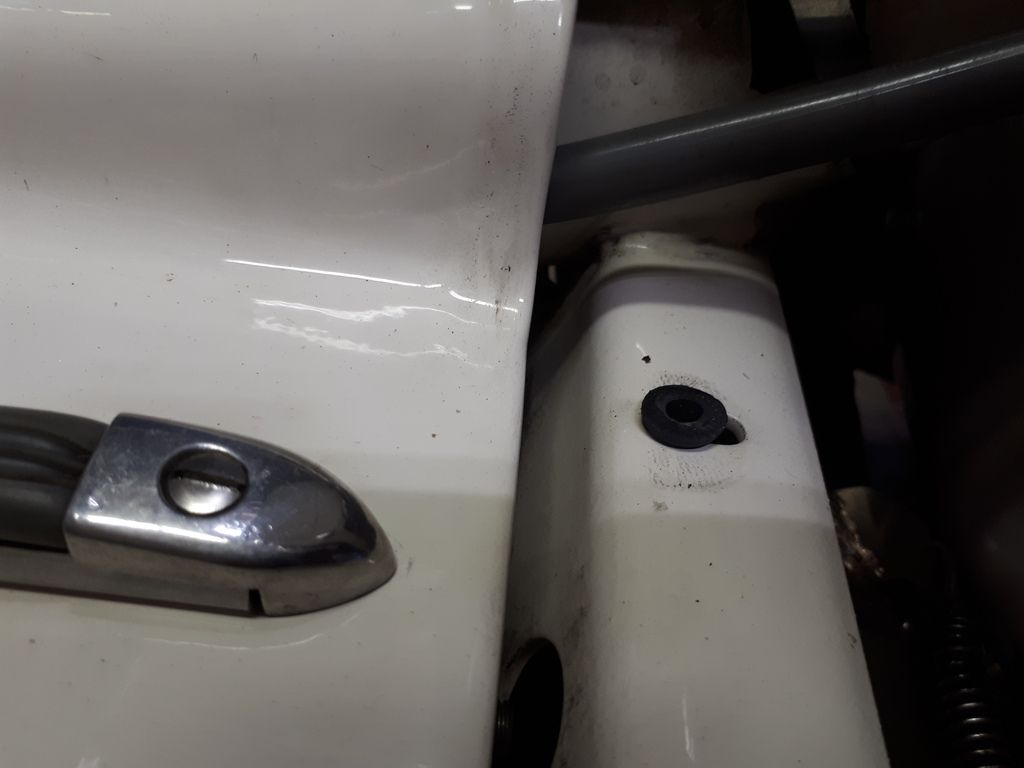

I use stainless M5 caged nuts here. Simply elongate the holes in the cross tree and make them 8.3 mm wide. This then allows the bridge piece to slide into place once you have the screws in place. Less fighting with the rubber gaskets and no burning your hands on a hot exhaust.
