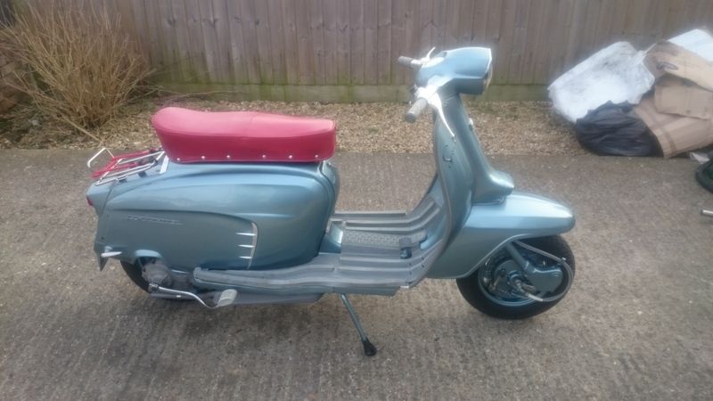

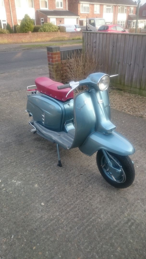

Postby Kristof Lammy pie » Sat Mar 12, 2016 6:30 pm
She's all back together, new piston and rings, gaskets, plug and new Scootopia Ancillotti exhaust and it runs great.
A bit of smoke on start up but I'm guessing that's the grease etc when I built it up.
I just need to go through it now for and prep it for the mot.
Kristof Lammy pie

Re: Lis 125 starting issues
Postby Warkton Tornado No.1 » Sat Mar 12, 2016 7:01 pm
Lovely bike! That colour is so 'Corgi/Dinky two-wheelerish' but no worse for it!
Toy manufacturers must plant a subliminal message in the minds of the young, methinks.
