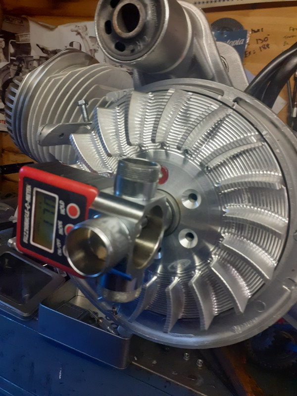

I think I must be missing something, but I would have thought to use the buzzwangle accurately you would need to make sure your engine would need to be perpendicular
missing lynx
Posts: 891
Re: buzzwangle
Postby Knowledge » Fri Jan 15, 2021 7:34 pm
The flywheel needs to be vertical for it to work. As long as the centre-line of the crank is horizontal, then the Buzzwangle will work.

I'm sure there are stick-in-the-mud tuners out there still removing engine mounts to fit degree discs the size of a Ferris wheel just so they can be accurate to half a degree on port timings. Or you could pop this into the flywheel and measure to 0.2 of a degree...

I borrowed a mates Buzzwanglre yesterday to check my timing marks as im fitting an external pick up, so easy to use , fantastic bit of kit.

Brilliant bit of kit, once you use one you wonder how you managed before,saves loads of time, great for setting timing or measuring port durationc

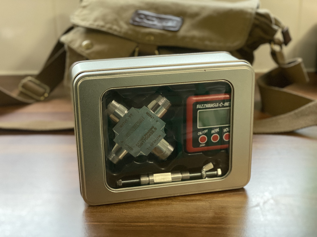

To be clear, that isnt the Buzzwangle, that one is just the cheap inclanometer others have mentioned plus a push in bracket for it to sit on. I have one of those brackets and whilst it does sort of work, its not vey secure and no good at all for measuring port timings.
My in laws bought me a Buzzwangle last year and the two dont compare 8-)
