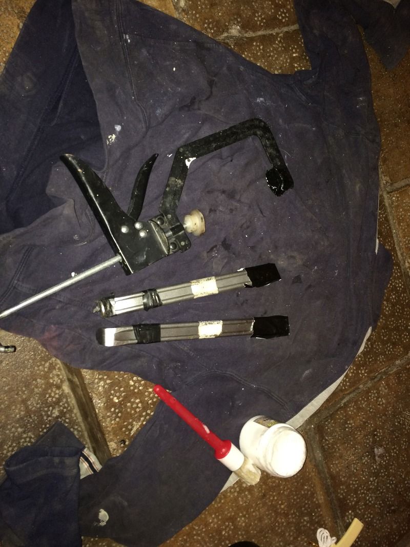

Well, the rims arrived and so did 2 new ScootSmart 350/10 59J tyres (great service thanks Martin ;) ) I was a bit pressed for time (I'm supposed to be sanding a floor ;) ) so decided to have a go at home rather than head over to Lambretta Rehab. First attempt involved warming the tyre on the radiator but despite copious amounts of special tyre soap I couldn't even get the first bead on.
So I fired up the Arga took all the shelves out and got it good and warm but not really any better. At this point I noticed that the tyre soap wasn't all that slippery so applied a squirt of washing up liquid and tried again.....MUCH better, the bead actually felt like it was wanting to go on, I pushed the rim in as far as possible and used a ratchet cramp to hold it in place then laid the rim plat and knelt on either side of the tyre and used a lever to gradually ease the tyre over the rim which took no more that 30 seconds or so. Applied more washing up liquid to the other bead, forced the bead over the rim as much as possible by pushing down with my hands and used the cramp to hold it in place whist using the lever as before, 2nd bead on in under a minute. Couldn't find my valve tool so connected my electric pump, started it up and bounced the wheel a few time and it started to inflate 8-)
2 very small scratches due to me not de-burring the tips of the levers, I had wrapped the ends in a layer of duct tape but not covered the tips sufficiently either. That tyre btw is a very heavy construction as it is a hi load tyre, the next one will be a bit easier as it's a lower load version of the same tyre.

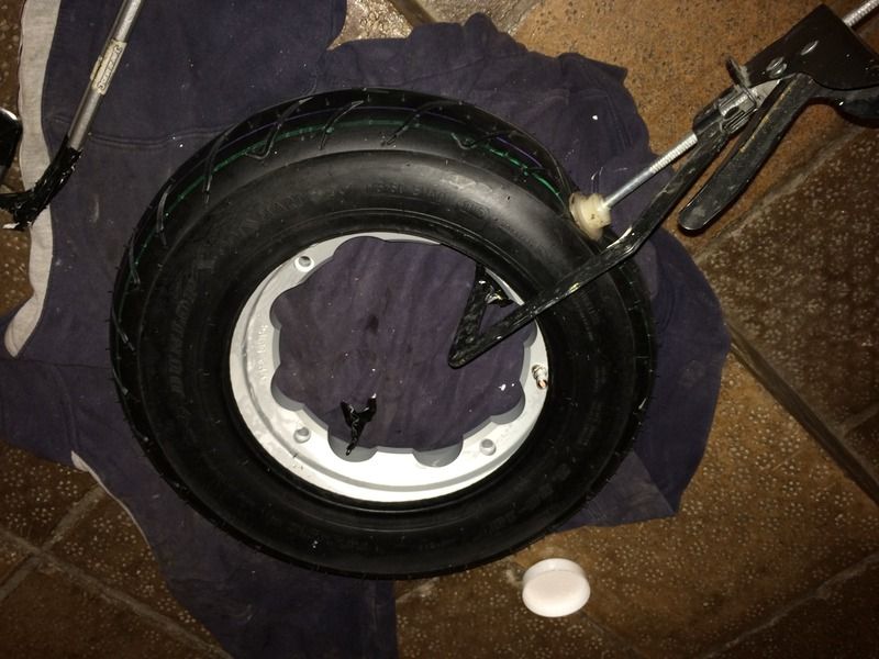

Here I have wedged the other side of the rim as far as I could by forcing using hands only and the cramp is keeping it in place

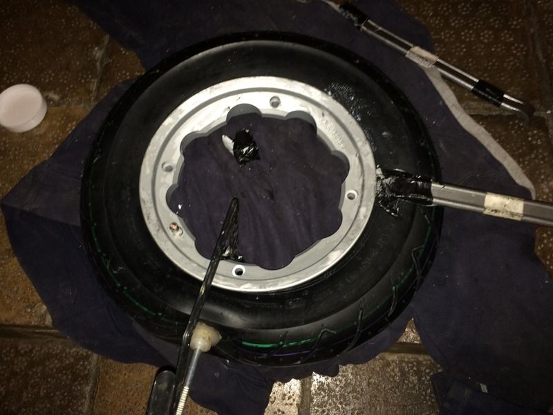

Ta da...

Yes to be completely honest it would have probably been easier as I guess you would be able to force the tyre part way on and hold it in position with your body rather than using the ratchet cramp. However, those base plates are going to cost around £40 with delivery and even without the base plate, using the cramp is easy enough and once I'd hit on that method fitting the whole tyre took no more than a few minutes. The only slight disappointment was the small scratches on the edge of the rim and as I had opted for the matt media blasted sort of finish there isn't anything I can do to rectify it (not that it's noticeable from a few feet). If I had the polished rims it would have polished out and powder coat would most likely have been tough enough to cope. The second tyre went on just with the tyre soap but with a bit of water in the brush, no washing up liquid.
