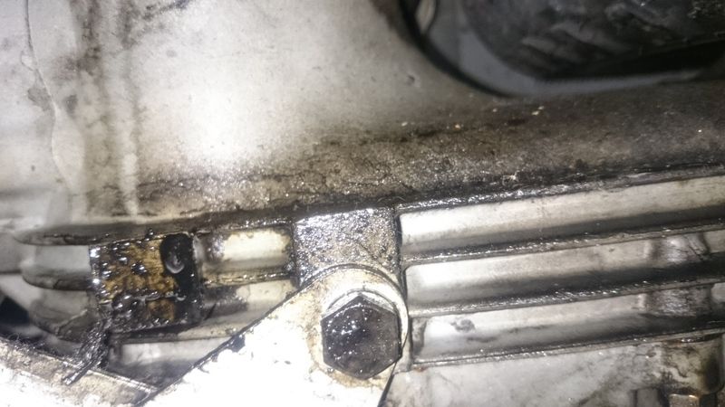

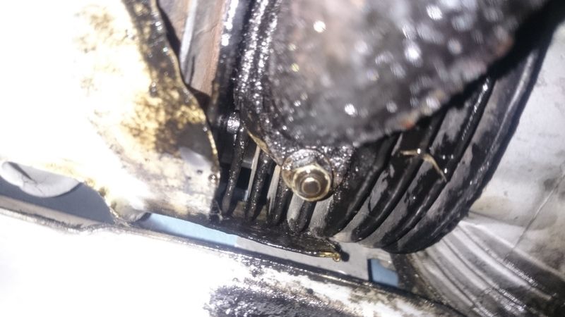

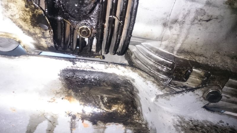

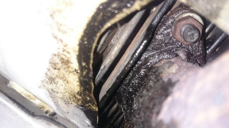

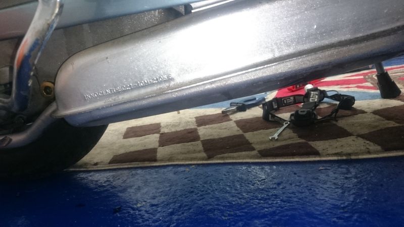

Postby Kristof Lammy pie » Wed Feb 10, 2016 10:15 am
A few pics underneath.
Bottom of the casing has a slight bit of oil on it.
Left exhaust stud not too bad.
Right exhaust stud leaking quite heavily maybe a snapped stud or crack in the u bend.
Barrel and head gasket look good but you can see the leak blowing against the exhaust.
Kristof Lammy pie
Posts: 298
Re: Lis 125 starting issues
Postby Marty ULC » Wed Feb 10, 2016 10:29 am
With any luck it's just a blown exhaus gasket or the nuts are loose. I'm a fan of solid copper gaskets and using the chain guide locking washer as per sticky's manual.
Marty ULC
Posts: 610

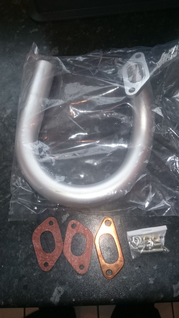

Postby Kristof Lammy pie » Wed Feb 10, 2016 10:44 am
Hope so.
My bits arrived today

Postby Kristof Lammy pie » Wed Feb 10, 2016 11:21 am
Does anyone use any sealant on the inlet or exhaust gasket?
Kristof Lammy pie
Posts: 298
Postby Storkfoot » Wed Feb 10, 2016 12:01 pm
No. I just try and make sure that everything mates together well and the exhaust isn't stressed at the swan's neck and tailpipe. This can be hard to achieve and always seems to involve, at least, taking a file to the face of the U bend manifold to get it 100% flat.
I know other people do use a sealant on box type exhausts.
Have you bought a new exhaust as well?
It does look like your exhaust casket is leaking but, as I have said, don't assume this will be the only leak.
Posts: 2540

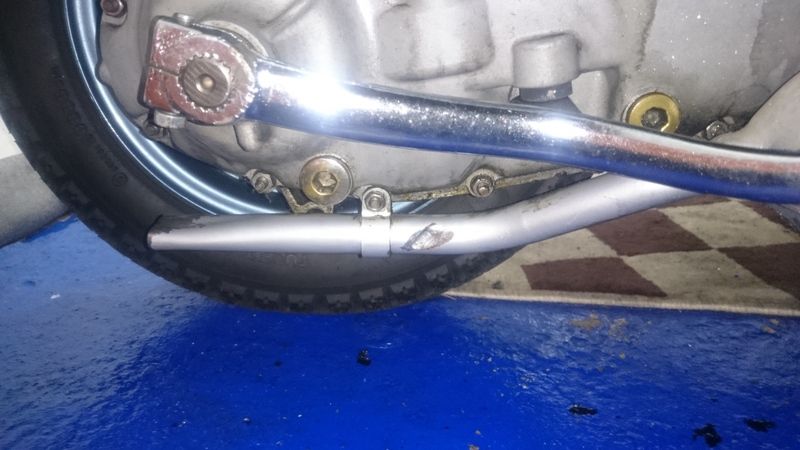

Postby Kristof Lammy pie » Wed Feb 10, 2016 1:28 pm
No I've just bought the u bend.
The exhaust is in really good condition,might be original but probably a copy. Annoyingly it has a gouge out of it from the kickstart which really grips me that someone let that happens without grinding the tag off a bit.
Kristof Lammy pie
Posts: 298
Postby Storkfoot » Wed Feb 10, 2016 3:40 pm
I have 4 or 5 u bends knocking around my garage. All are different in shape and length. You'll be very very fortunate to find that the one you have bought matches the one you take off. Be careful, forcing it to fit is bad.
It may well be that is the original exhaust, albeit with a splayed flat tailpipe. However, box exhausts are prone to getting bunged up with rust and gunge. In that condition they will badly stifle performance.
