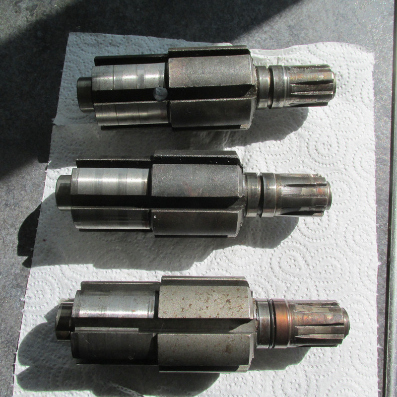

Postby dscscotty » Mon May 04, 2020 10:11 pm
Snapped layshafts are more common than you think, here's 3 just in past few yrs, plus I know of several others, each one tells a heart pumping, arse clenching tale!

Re: New Layshaft
Postby shamrockexpress » Wed May 06, 2020 12:42 am
cant argue with that,,,,,,,,,innocenti paper weights lol
