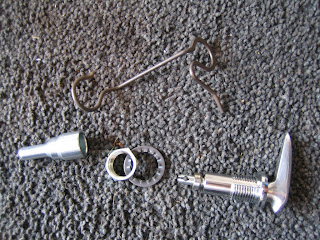

Can anyone tell me what this is or where it goes?
I think it was behind the choke finger lever very close to the head cooling cowl but could be wrong, was 15 years ago.
The hole is 16mm dia and it is steel and was metallic blue.
Can't spot it on any of the Scoot Rest pictures.
Found it on google of course, keeps the cables away from any hot areas.

Postby dickie » Sun Feb 22, 2015 2:11 pm
911hillclimber wrote:Thanks, but lock suite awaited from Buzz now.
Yes, you're correct it goes on the back of the choke lever.
If you look on Paul slacks (excellent) rebuild guide on the lcgb home page you can see where it goes. Only difference is he has the earlier wire one, but it's essentially the same.

Postby Noddabodder » Mon Feb 23, 2015 11:49 am
I think its more for stopping the cables pushing the plug cap off rather than avoiding hot areas.

Postby Paul Slack » Tue Feb 24, 2015 3:44 pm
Dickie is correct. The metal part you have is a cable guide.
It slots over the choke lever body on the inside and is held by a large crimped washer and nut.
Older ones were sprung wire. Yours is the plate type and can only fit one way around. When fitted, it holds all the cables away from the spark plug in that small recessed section that is turned over to stop the plate damaging the cables.
This blog might help you with any future problems:
http://lambrettarestorations.blogspot.c ... choke.html

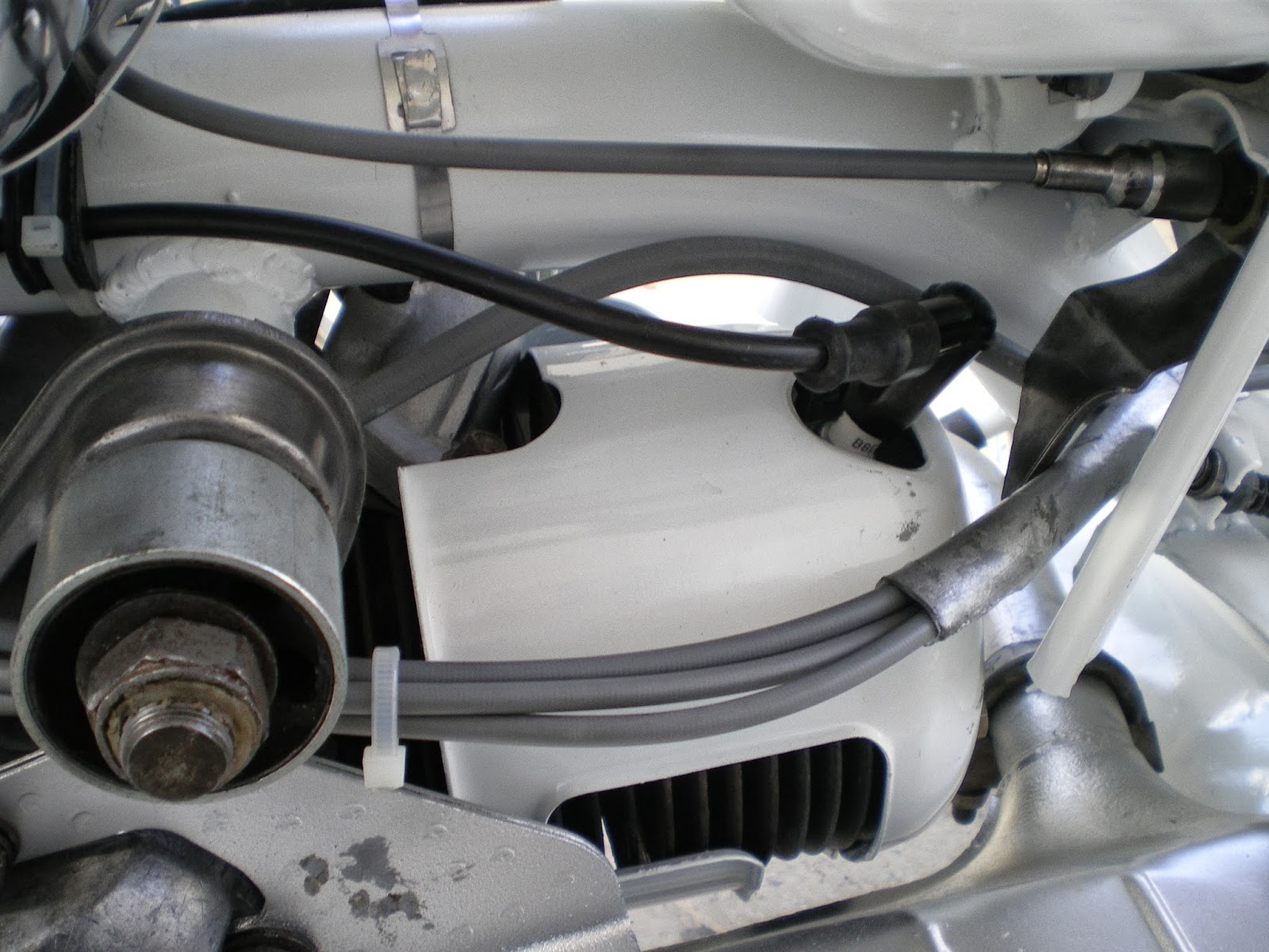

Started on the fitting of the cables and loom today after a few days off.
Everything fell into place well and I think I have the two gear selector cables in the right place, but yet to connect everything at the engine end.
The loom is new. The existing loom on the light switch has very brittle PVC sleeving though the wires themselves are ok. I've replaced most of it with new.
Positioned the loom by installing the brake light switch and connecting that which positions the loom a treat. Saved the water proof (?) cover off the old loom which was good. Passed the loom to the head stock using Stickys guide and insulation tape to get the cables and the loom to the frame.
Then to the rear which is when it went downhill a bit... :roll:
Cleaned the Ducati regulator and mounted it on the frame. Then started to wire it all up.
Being a bit thick it took some time to dawn on me one row of 4 females are for the stator males, and the other row of 5 females are for the loom males...it is my age.
Then one of the female connectors snapped. :shock:
Refusing to buy a new regulator, a deep strip down and a bit of soldering and a new 'normal/round' connector soldered in place saw the lot all wired up. Must admit to being chuffed with that, far too easy to buy and buy again.
It might be knackered of course, but time will tell.
