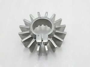

Still on cooling, but has anyone tried a finned exhaust clamp, like these?
I think it was Jarv from Norwich, who spoke about these years ago.
If I thought they would help and there was enough space I'd try one.

Postby ULC Soulagent » Tue Apr 21, 2020 11:55 am
Wonder if it’s a take on the flying Kettles exhaust collar, although not sure if it was was aesthetic reason or had a purpose since it was an water cooled engine :roll:

ULC Soulagent wrote:Wonder if it’s a take on the flying Kettles exhaust collar, although not sure if it was was aesthetic reason or had a purpose since it was an water cooled engine :roll:
Standard fittment to pretty much all British bikes in the 60's. Would make access to the flange studs a bit awkward on a lambretta :?
