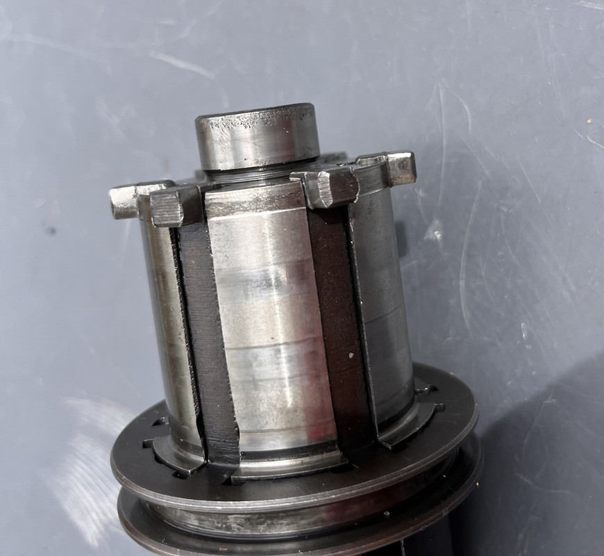

I had another look at the layshaft. The pitting isn’t too bad and I am sure in years gone by, I’d have just stick it back in. But, there is a ridge where first gear sits. You can see it in this photo and you can catch your nail on it.
Let’s see if I can set up one of the new layshafts when they come back from the machine shop. If not, I may well just put this one back in. The threads and splines are spot on.

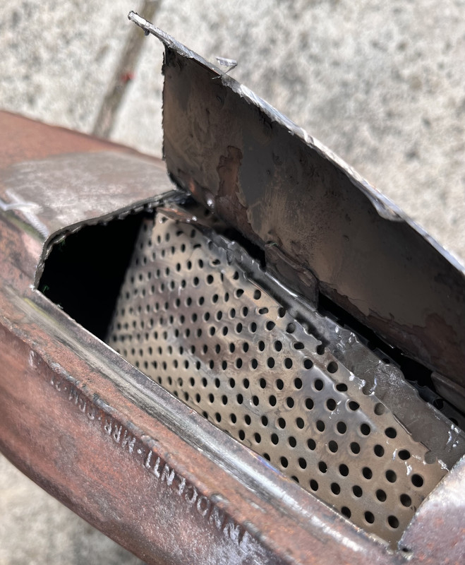

Superhooper kindly passed on an old bgm Clubman to me with loose bits inside.
I have cut one open before to get baffles welded back in. But, the one I cut open before was a V1 and I think this is a V4. My recollection of the V1 is that cutting open this area would lead you to the main baffle plate. It doesn’t with the V4. There’s a chamber welded in before that.
On the plus side, the only part that is rattling around in this exhaust is the wadding type plate with holes in you can see in the picture. So I’ll just get that spot welded back and the shell welded back up.
Whether it works well with this engine is another question :)
