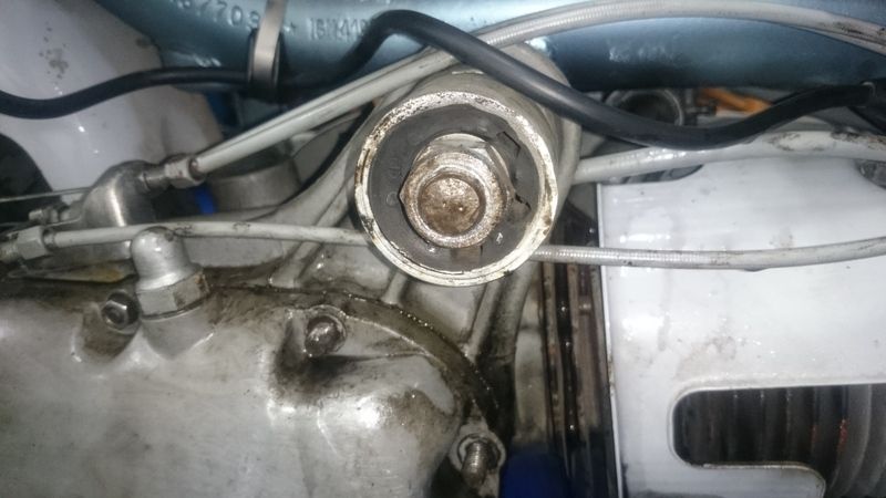

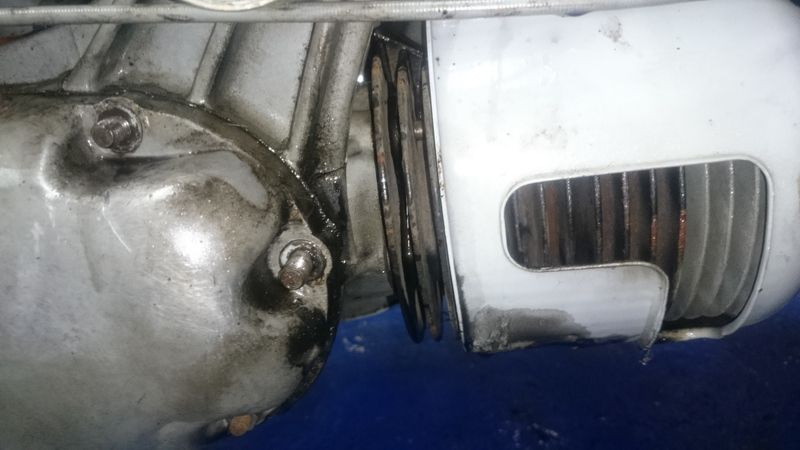

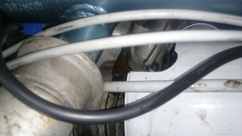

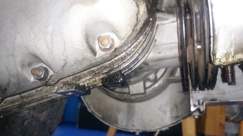

If all that oil is coming out the cylinder exhaust port then there is something seriously wrong with your fuel mixture or you have a leaking crankcase seal which is the more likely.
Actually studying your photos it looks to me like either excess crankcase pressure is forcing the oil out of the crankcase breather ,( hole in your piston or rings are worn or broken), or ... your cover gasket is leaking
johnnyXS

Postby Storkfoot » Fri Feb 19, 2016 6:27 pm
To me, looking on an iPhone, that looks entirely symptomatic of a leaking exhaust gasket. They do produce black gunge just like that when leaking.
A couple of points:
The exhaust. If it was me, I'd clean the inside with caustic soda if I was going to refit. It could well be all gunged up inside. I'd also make sure the mating surface was flat.
Fitting a kit. In what way do you believe this will resolve any issues? Again, if it was me I'd take the engine out and give it a thorough going over. Sticky's manual shows you how to do this very well
