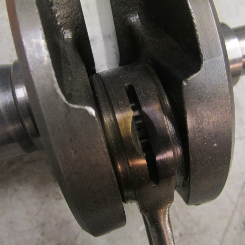

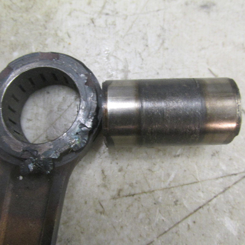

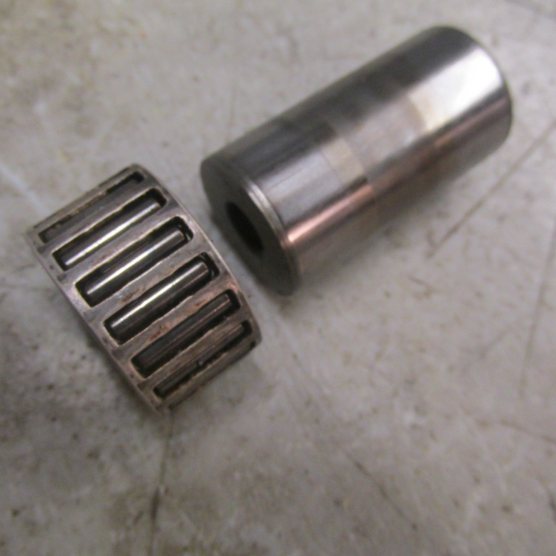

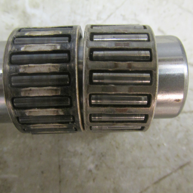

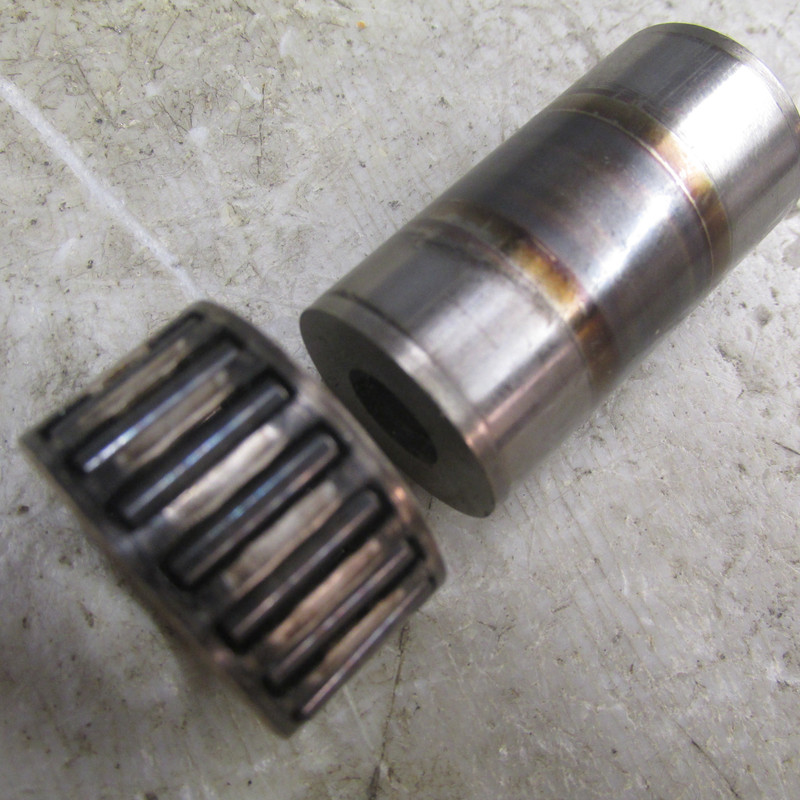

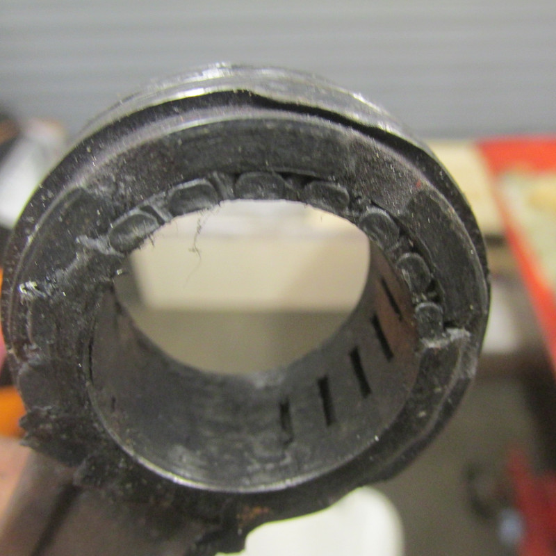

So had a little time to photograph crankshafts/Big end bearings that have been run on exol,
Pic1-2 This was a TS1 motor, the conrods big end eye showed signs of overheating (Bluing) as did the BE cage and the rollers,
Image,
Pic 3-4 another big end ran on exol-bluing/overheating visible on rollers/ cage/ pin
pic 5-6 Big ends/pins from TS1 running motul semi
Big ends exol-motul semi
spot the exol ran BE
Crank pins-exol
non exol
When it all goes wrong an RB20 rod/bearing/pin=The owner was running a high grade castrol fully synthetic @2% after listening to his mates and reading internet forums regarding 2 stroke oil % ratio's , a very expensive lesson in the art of Lambretta crankshaft under lubrication.

Postby Warkton Tornado No.1 » Sat Jun 01, 2019 9:28 am
As none of us are in 'laboratory conditions' where everything can be verified for precise comparison, we can only go with our own experiences & preferences.
From what can be seen, that particular RB engine doesn't seem to be happy with a crankshaft run with Exol, but I have experienced no such issues with the engines I have built. :)
That said, the oil way slots in the conrods I have, have always been enlarged significantly compared to the one that is depicted having failed. Just saying...... :D
Posts: 2306
Re: EXOL OIL
Postby dscscotty » Sat Jun 01, 2019 9:44 am
The knackered RB rod was actually ran on high grade castrol fully synth but @ 2%, he just spent to much time listening to his mates and reading internet forums, and did not heed advice or infact those of the supplier/manufacturer who states in their info regarding the kit that %4 is a requirement, this was a very expensive lesson.

Postby Scooterdude » Tue Jun 11, 2019 6:47 am
I’ve just started using Exol fully synthetic at 4% as a sort of experiment really more than anything else, my thinking is most people seem to run this oil at 3 or even 2% and complain about ring sticking.
Judging by the pictures above 3 or 2% is clearly not enough oil and apart from the excessive wear obviously there will be a lot more heat generated, so I’m wondering could this excessive heat be over cooking the oil to the point of turning it into a thick tar like substance hence the ring sticking and blocked ports etc? is that plausible, I’ve no idea.
