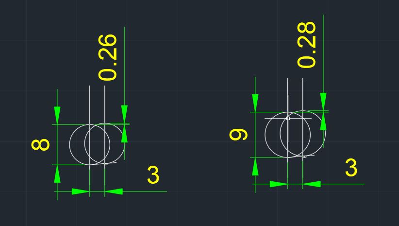

Larger ball-bearings will only increase the preload on the actuator spring. This will help the lever to return after operation but won't increase the pad movement or force.

dickie wrote:Larger ball-bearings will only increase the preload on the actuator spring. This will help the lever to return after operation but won't increase the pad movement or force.
Hmmm. Actually, the bigger balls will give greater movement for the same angle of lever movement. That’s not to say I have any experience or knowledge as to whether the modification is worthwhile :D

Postby dickie » Tue Nov 12, 2024 8:11 am
I did try this a couple of years ago and it made no difference. Then I sat back and wondered why. It's pretty obvious when you think about it, that the movement rate is only affected by the angle of the 'cups' that they sit in. If you move those surfaces apart before you move them, it doesn't change the rate, only the starting point. This is nearly the same as adjusting the static pad.
I wasn't completely convinced so I modelled it in autocad to prove it to myself. When I get to work later I'll do it again and post the results on here.
I know it's intuitively correct, but in reality it does nothing.

Postby LambrettaMarky » Tue Nov 12, 2024 9:37 am
Interesting. The increased diameter ball to 9mm from 8mm will position the starting point of the pad 1mm nearer the disc in relation to the actuator being in the same position courtesy of the circlip retention?
By doing this the point of contact where the brake/disc first touch is nearer to the starting point of the ramp/dimple. I haven't studied the ramp/dimple angle in my unit, so it is really guess work that the actuator will have more movement or throw of the pad itself in the initial part of it's movement from rest.
I'll let you know what I find, but for sure if the ramp/dimple is more a flat bell than a V it should be beneficial (I hope..)

Postby dickie » Thu Dec 05, 2024 12:12 pm
dickie wrote:I did try this a couple of years ago and it made no difference. Then I sat back and wondered why. It's pretty obvious when you think about it, that the movement rate is only affected by the angle of the 'cups' that they sit in. If you move those surfaces apart before you move them, it doesn't change the rate, only the starting point. This is nearly the same as adjusting the static pad.
I stand corrected. It does make a difference, but a small one. Also, you have to bear (get it?) in mind that increased travel is at the expense of reduced force for the same pull at the lever. Regardless, bigger balls make a slight difference. 1mm increase gives about 0.02mm greater piston travel for the 3mm which I arbitrarily used as the distance the ball would roll across the dimple.
