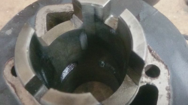

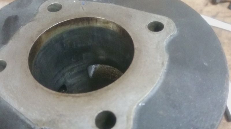

Postby Kristof Lammy pie » Sat Feb 20, 2016 4:59 pm
The barrel feels smooth with gouges or nick's
Slight mark on the barrel but you can't feel it
I'm confused as this looks like an original barrel and head?
Any ideas anyone?

Postby johnnyXS » Sat Feb 20, 2016 7:09 pm
have a look at the top of the piston Chris It should be marked if its oversized .
If the bore is ok and the piston is not scored I would be tempted to hone the cylinder very lightly with some 250 grade wet n dry to remove the glaze and fit new standard rings to the piston and put it back together.
