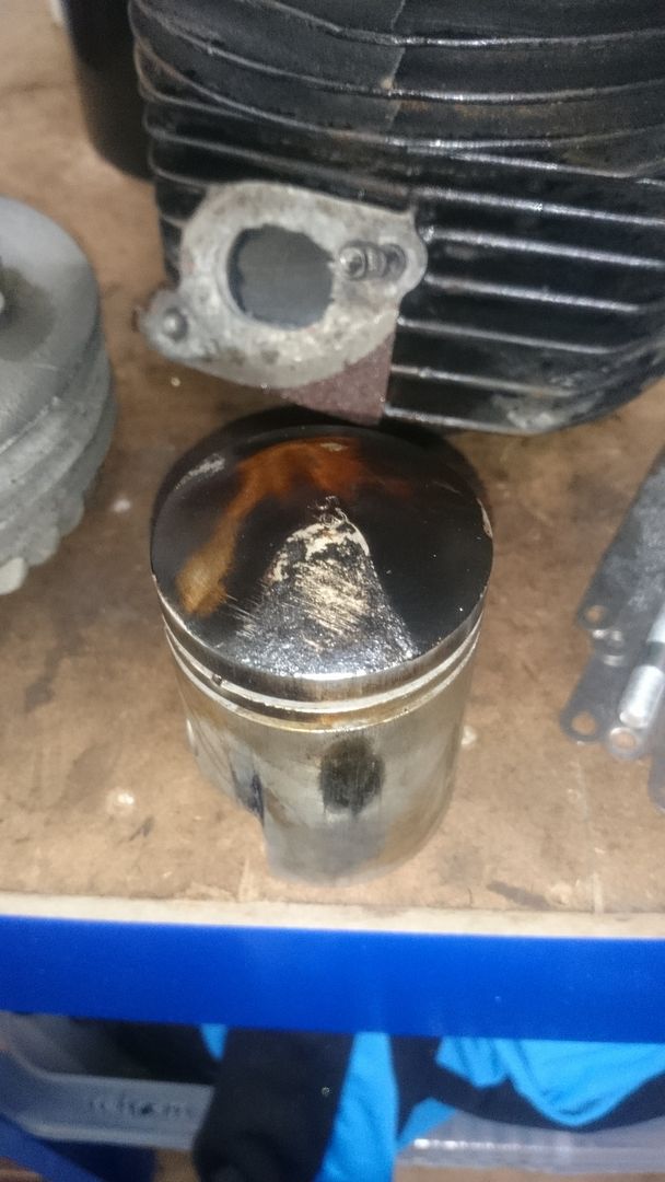

Postby Kristof Lammy pie » Sat Feb 20, 2016 10:00 pm
Would you say this piston has suffered a partial seizure?
It's heavily marked with carbon and burn marks,
There is a light score on the piston directly underneath it.

Postby HxPaul » Sat Feb 20, 2016 10:19 pm
If the shims dont appear worn i would use them again.As for the piston rings,if you insert them into the cylinder and measure the gap.The gap should be from 0.16mm to 0.6mm.
Re: Lis 125 starting issues
Postby HxPaul » Sat Feb 20, 2016 10:25 pm
johnnyXS wrote:have a look at the top of the piston Chris It should be marked if its oversized .
If the bore is ok and the piston is not scored I would be tempted to hone the cylinder very lightly with some 250 grade wet n dry to remove the glaze and fit new standard rings to the piston and put it back together.
Its a pity you didn't test the compression before you removed the head because that would have told you something about the state of the engine components
If there is no score marks in the cylinder,I'd do as jonnyXS says and clean the cylinder and piston and check the ring gaps and rebuild.

Postby johnnyXS » Sun Feb 21, 2016 12:06 am
its difficult to see what has happened to the top of the piston from the image but I would suspect it is the result of detonation. At some point in the past the engine has run lean and hot and with the wrong timing perhaps .
I would just dress it off as well you can so that carbon doesn't accumulate. The burn mark on the piston is very typical and looks like the underside as it is fitted. it will wear , get hotter and burn more than the sides and top of the piston due to gravity ;) Its not due to seizing and not a problem

Postby Kristof Lammy pie » Sun Feb 21, 2016 5:56 pm
Measured the rings in the barrel and the gap is 0.6. I take it that's just acceptable?

Postby johnnyXS » Sun Feb 21, 2016 11:38 pm
according to stickys manual the maximum permissible gap is 0.55m for 125 and 0.6mm for 150 so they are useable but on the limit . It would suggest that the engine wasn't rebuilt a few hundred Km ago ;)
I would put some new rings in regardless but make sure you really clean the ring grooves thoroughly and with new rings you'll definitely need to take the glaze of the bore with some very fine wetndry or better still buy a cheap honeing tool like this one .http://www.ebay.co.uk/itm/19mm-62mm-Car-Engine-Brake-Cylinder-Hone-Flex-Shaft-Bore-Honing-Tool-New-/191393445002?hash=item2c8ff0348a:g:ywQAAOSwQPlV-AEY
Bung it back together and run it so that you can test everything like the gearbox, brakes etc and then you'll be in a better position to make an assessment as to how much work you want to do on the scoot .

Postby Kristof Lammy pie » Mon Feb 22, 2016 8:35 am
I think in going to have to get a piston too.
There is a flat on the side and I can get a 0.05 feeler gauge in.

Postby johnnyXS » Mon Feb 22, 2016 9:16 am
mmm that sure doesn't sound like an engine that has supposedly been rebuilt does it.
Now you are defintely going to be better off by far buying a complete cylinder piston and ring set . that way everything will be matched and fit well and you won't have any expensive Engineering costs.
I saw a 150cc kit the other day for about 80 quid. here we go http://www.ebay.co.uk/itm/Lambretta-Li150-Cylinder-Kit-Barrel-Piston-and-Head-SX-GP-/281918325374?hash=item41a3a4427e:g:XZkAAOSwksVTzn0h
Phone them and check it is the right one for your model as I am not that au fait with the 125 series .
