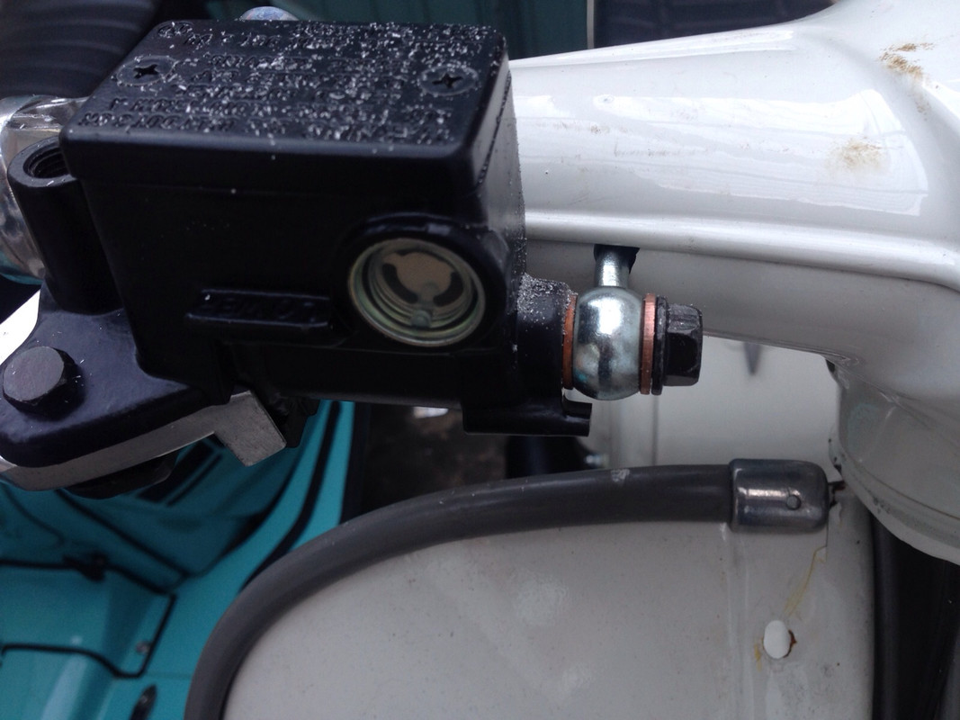

Postby Norrie Bodge » Sat Dec 29, 2018 9:58 am
Loads of room
I run hydraulic/thumb choke/CHT & Rev counters

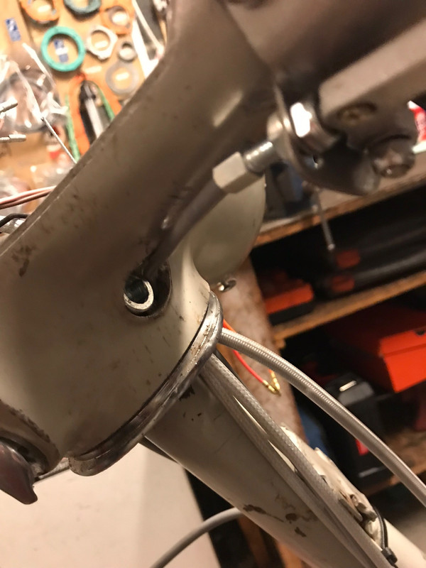

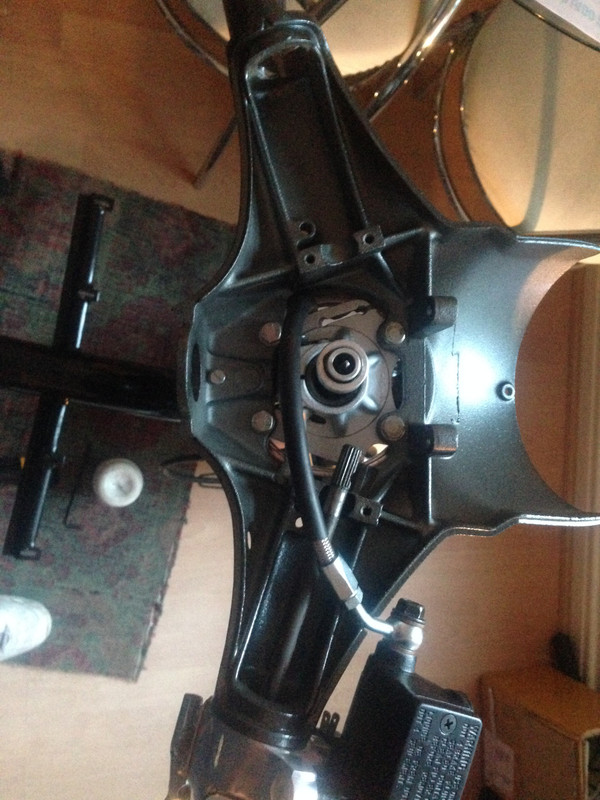

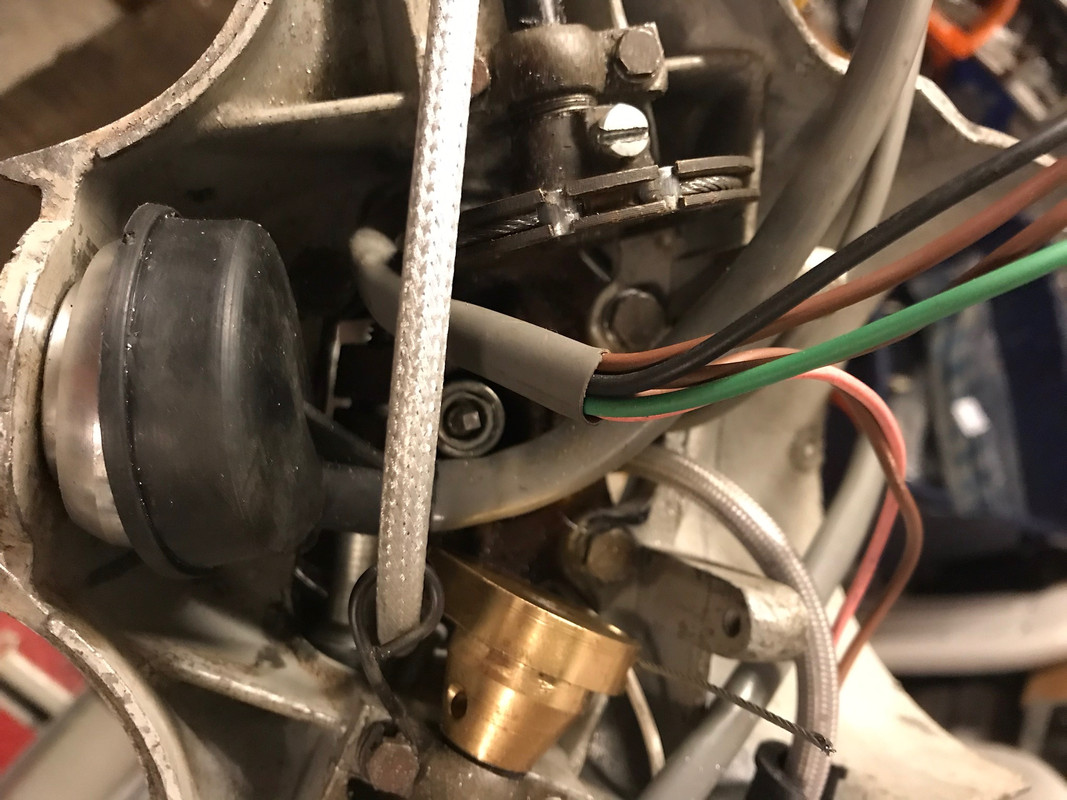

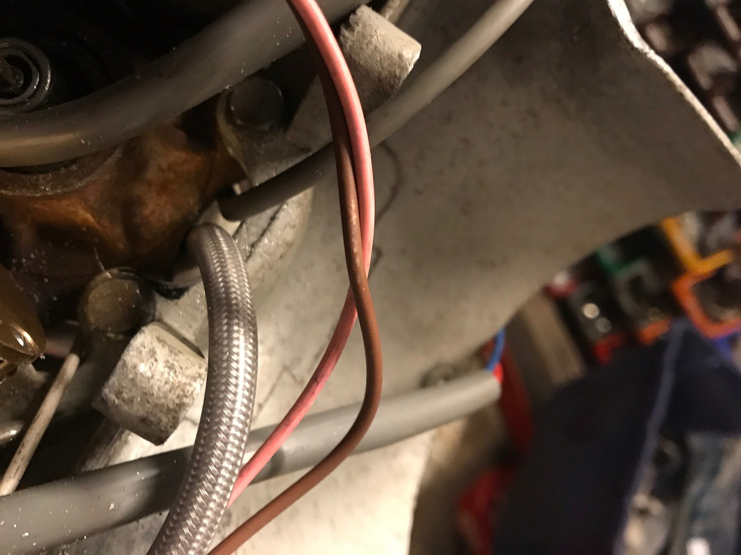

Postby Toddy » Thu Jan 03, 2019 7:20 am
I run similar to Norrie heres how ,
Thumb choke runs through Hole in the headset bottom along side the hgeadset clamp bolt
Clutch cable normal route
Hydralic disc cable comes up at the Front of the headset with a small fettle to allow movement
Wiring loom and extras come up the side of the gear wheels
i also have an ignition in mine as well
Hope this helps Toddy

Postby Toddy » Thu Jan 03, 2019 11:45 pm
Paul do you have a couple of photos as they may come in handy for my ongoing project?
Cheers Shane[/quote]
Here you go buddy not finished yet but shows what you need

Postby Stesjh » Sun Jan 06, 2019 5:26 pm
Many thanks for the pictures, very helpful

Postby Norrie Bodge » Mon Jan 07, 2019 8:01 am
Norrie Bodge wrote:Loads of room
heres mine they may help
