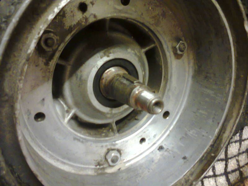

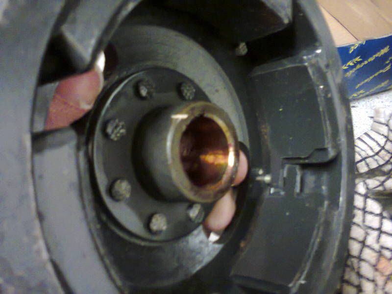

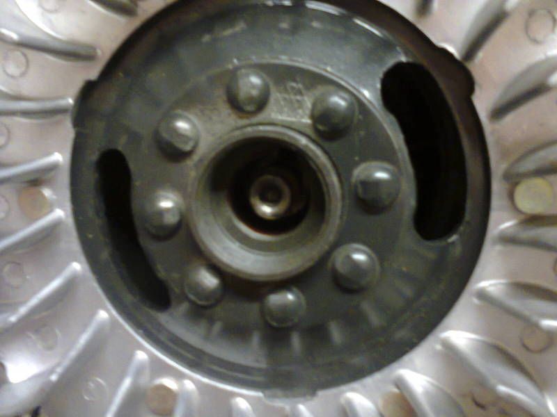

Postby IaninDorset » Sun Aug 31, 2014 10:32 pm
There's a few pics of the prob I have, the last pic shows the base of the flywheel up against the mag housing studs and the spigot hasn't even got enough to sneak a thread on the old centre nut :( So to me this looks like it needs the central bit to be is it concave rather than convex? Trouble is flywheels aint cheap and I can't afford to trial and error really so if someone can hit the nail on the head for me and say "yes that is such and such a flywheel" the electronic stator has a K2 pickup on it so I would need an electronic one as well although points is looking quite desireable right now just to get her up n running lol

Postby Knowledge » Tue Sep 02, 2014 10:41 pm
Looking the photos, my immediate reaction is that the crank is Li, and the flywheel is GP (DL). Does anyone else agree?

Postby Adam_Winstone » Tue Sep 02, 2014 10:44 pm
^... yep, I do.
