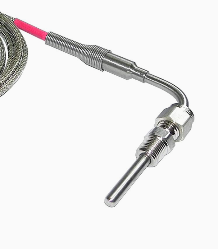

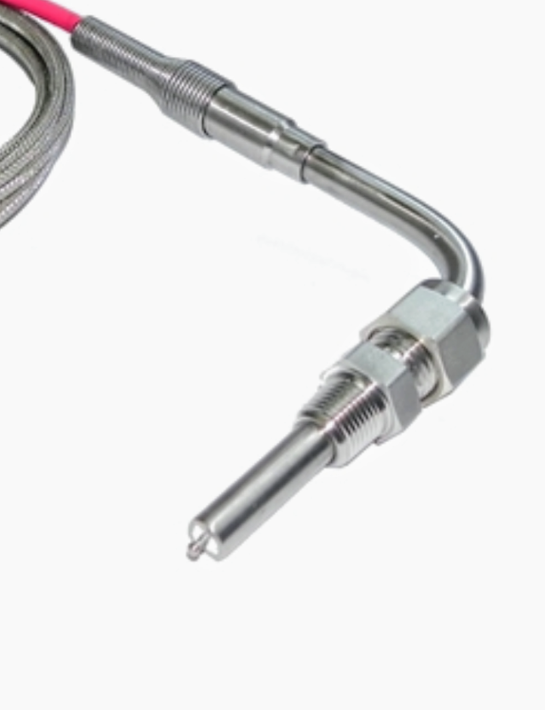

Postby Solid Air » Sat Sep 21, 2019 10:29 pm
This type?
Or this type?
I've heard the first type gum up, I use the second type and it would make sense that they last longer (?).
Re: Sip v gamma cost
Postby Scooterdude » Sun Sep 22, 2019 7:35 am
Ah, never seen the first type before but the second “enclosed “ type is what I’ve always used. When they go they usually jump to 1000 degrees for a few minutes and the display starts flashing then drop to 0 and that’s it it’s dead.
