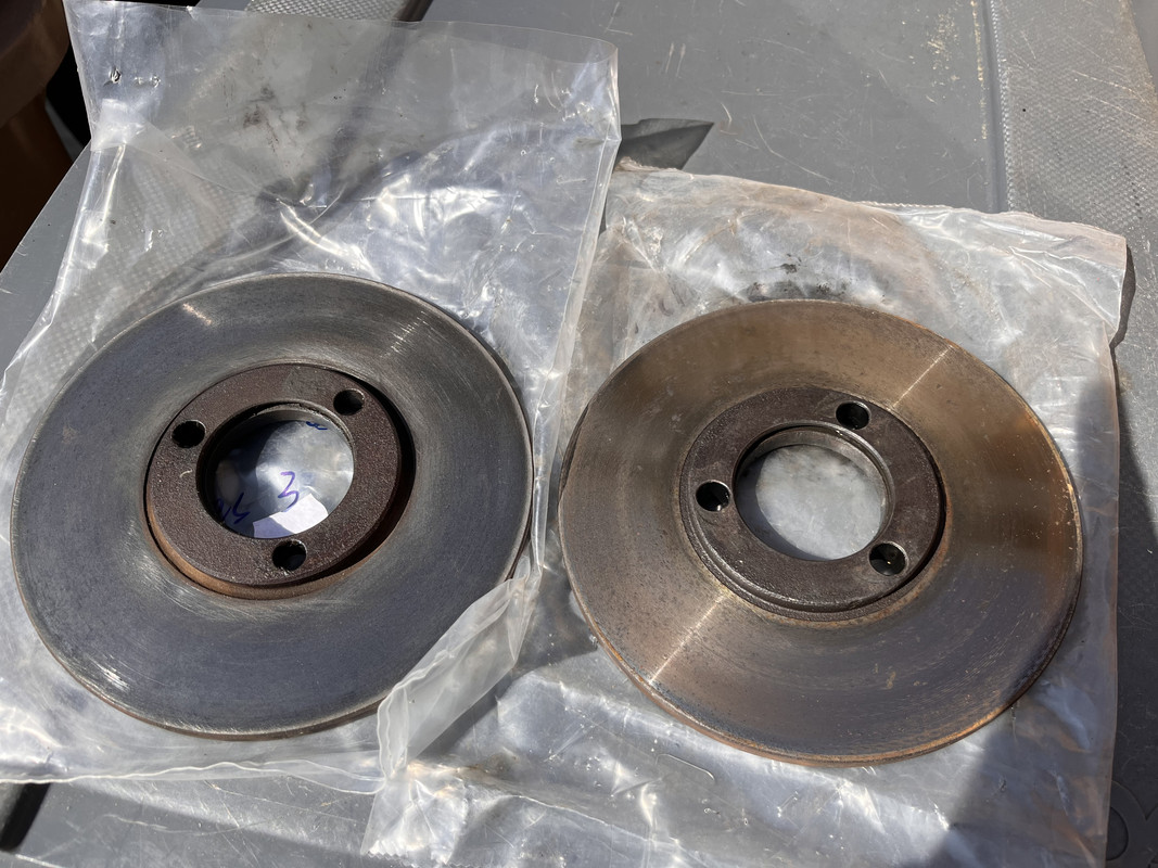

Postby Storkfoot » Sun May 21, 2023 9:42 am
I found a couple of old original discs, one of which I have taken the circlip out of. I’ll take them down to the engineers in the next few weeks.
