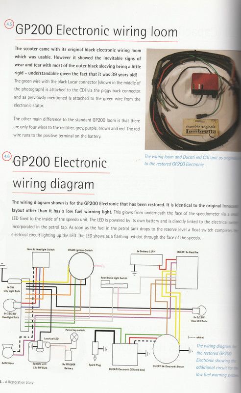

Can anyone point me in the direction of a wiring diagam please. Sticky's manual doesnt have one and I have trawled the internet without any luck.

There is a facebook group which has been discussing this.
If you use it here is a link
https://www.facebook.com/groups/716973338341379/
It looks as though there isn't a diagram

I scanned this from Michael Green's restoration guide book. It wasn't easy but I hope it helps,
