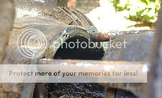

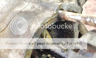

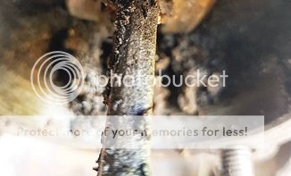

Out of curiosity, any idea what all the 'mud' is doing in the engine? Is that how oil goes if it's left to sit for a couple of decades? I'll try to upload some pics in a minute.
