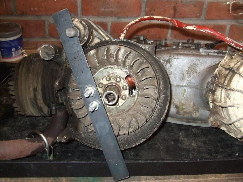

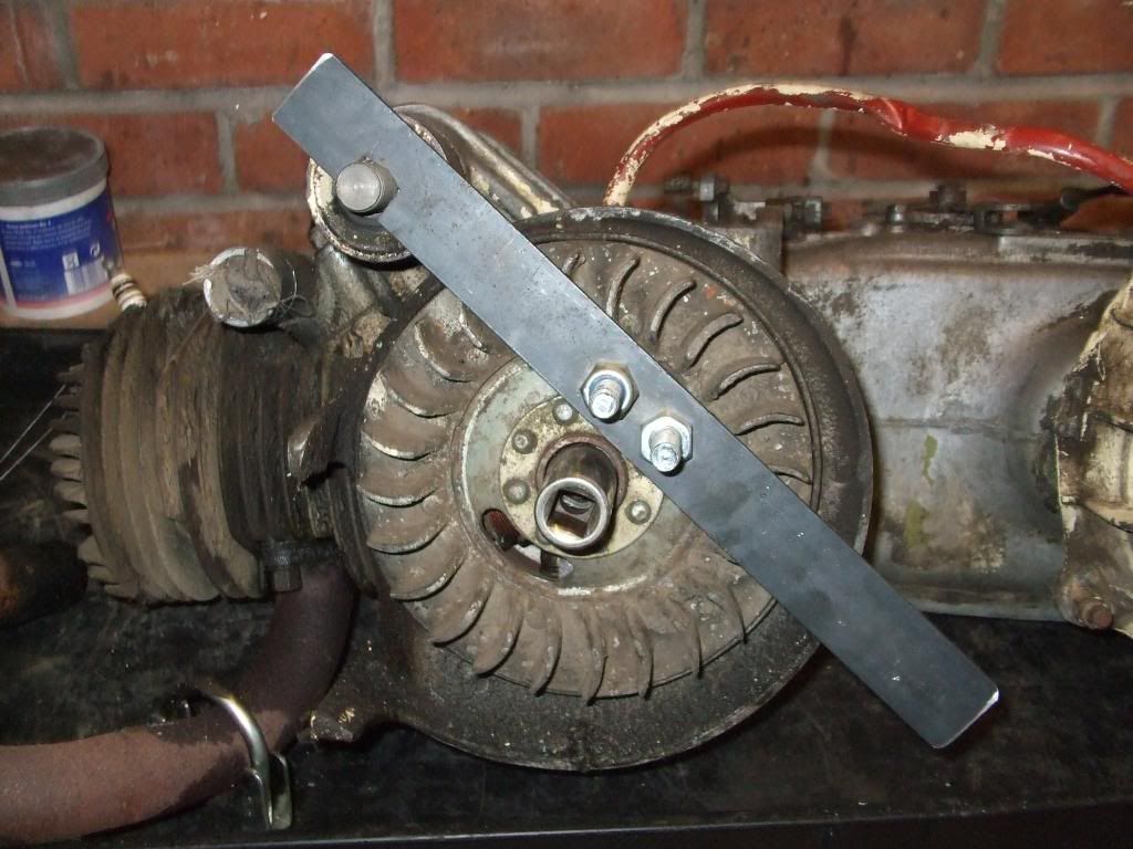

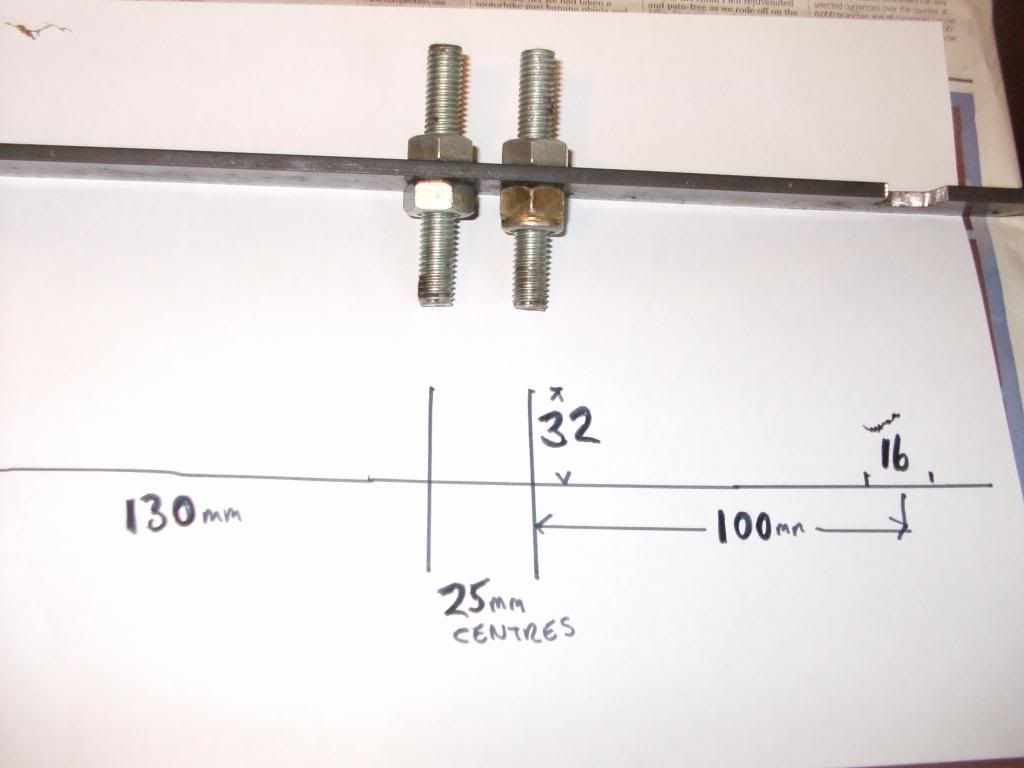

A flywheel holder can be made from a section of steel bar 30mm wide and 5mm thick available from hardware stores.Drill two 10mm holes and one 16mm cutout as per picture and use 10mm thread Image
If you remove the thread nearest cut out and file the end of the remaining thread to fit into one of the holes in the clutch spider the cut out will fit on the rear shocker post and you can hold the spider whilst tightening/loosening the spider nut

I can testify that this tool does in fact work very well ,made one last year and has come in very handy

Brilliantly simple idea, ust be a bit careful with the amount of thread poking into the flywheel as it would be easy to catch the coils

Does the holder have to be that overall length or would it work okay if it were trimmed just beyond the two threaded bars?

Marty ULC wrote:Does the holder have to be that overall length or would it work okay if it were trimmed just beyond the two threaded bars?
Hi Marty,
Cant remember why I made it that long as it was posted on old forum but probably made it that long to provide a handle for extra safety.
