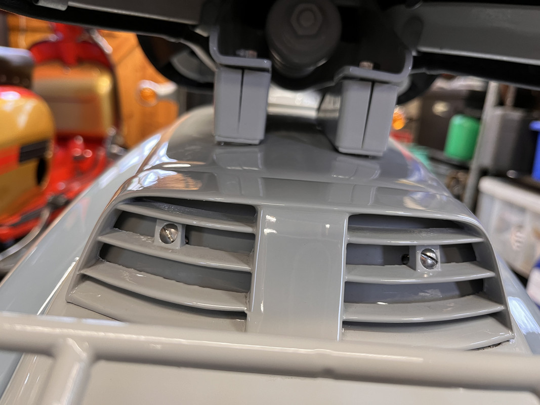

The rear seats are harder to come across. Here’s the back of mine. With hindsight, I’d have welded up the join in each wedge.
