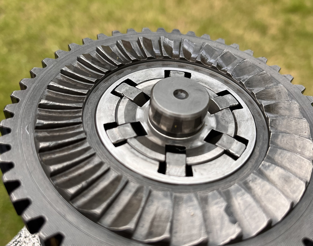

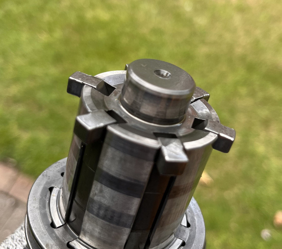

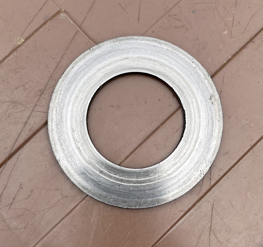

I now have the engine out of the frame and can see that the gear shim has been taking a battering from the gear selector when I have been trying to engage first gear.
From memory, the shim clearance was about 0.20mm.
It is hard to see from these pictures but the gearbox stack does sit almost 0.1mm above the Layshaft.
My question at this point relates to the position of the gear selector when in first gear. The selector sits above the Layshaft. Is this normal?
HiPaul,
Sadly I can’t view the images on this device, but I am struggling to interpret the final sentence above. Are you talking about the wishbone when you say “selector”?
Posts: 1999
Re: Problems selecting first gear.
Postby Storkfoot » Wed Jul 12, 2023 10:01 pm
Selector, sliding dog, cruciform for those Vespa inclined :D
Not the wishbone ;)

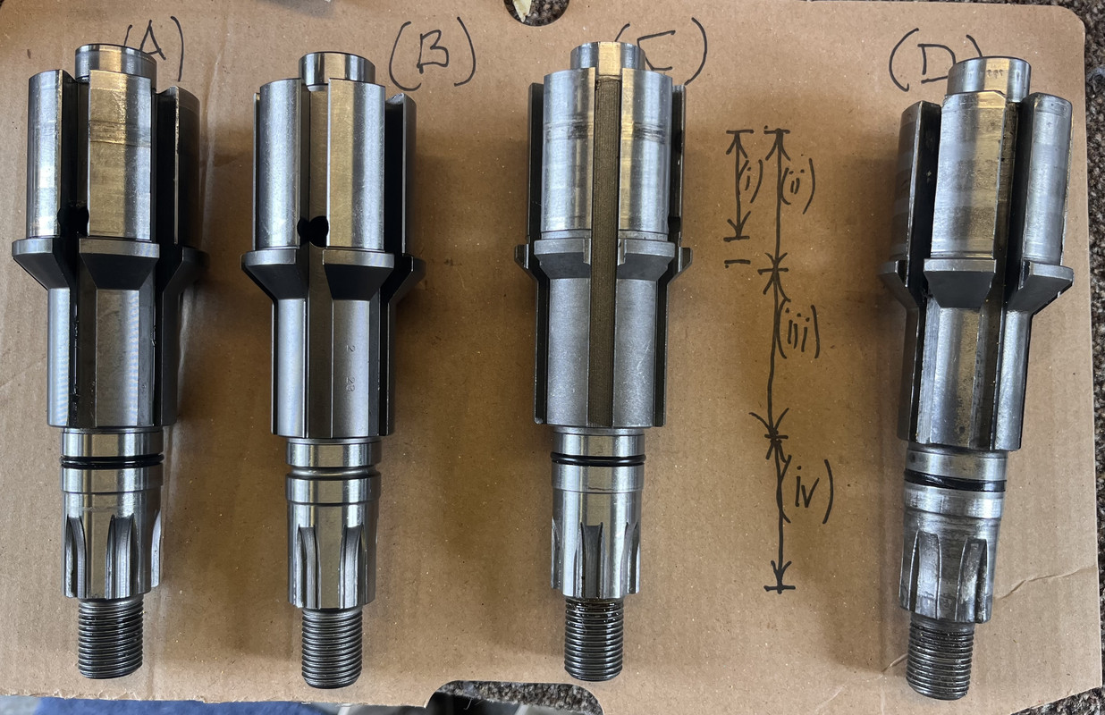

I now have 4 Layshafts. A - this is what has been fitted most recently, B - the invoice says this is a Casa Lambretta. It is not stamped Casa and I suspect that it is exactly the same as A which was an MEC/EUR Italian. C - this is one of the newish AF ones. I had this fitted originally. I took it out after discovering that I had an incorrect first gear fitted (now resolved). The case hardening around second gear has come off. D - is a battered old Innocenti one that I just keep to compare to.
You can hopefully see from the handwritten chart that the measurements of A to C are pretty similar. D, the original Innocenti, is the most noticeably different.
If I put the stack of gears (Innocenti GP125/200 gearbox with a replacement Indian GP200 first gear which is the same teeth and diameter as the Italian one) on all 4 gearboxes. In each case the gears stand proud of the Layshaft as they should. It is noticeable that the biggest gap between the gears and Layshaft, about 0.4mm, is with the original Innocenti Layshaft.
Going back to my query, the photo above with the steel rule shows what I am querying. When the gear selector is in the first gear position it stands proud of the Layshaft by about 0.5mm. Is this correct?
As I have had instances in the past were the ball bearings have been too big to pass through the Layshaft, I also measured the diameter of the channel which they sit in. All the aftermarket ones, A-C, are narrower than the original.

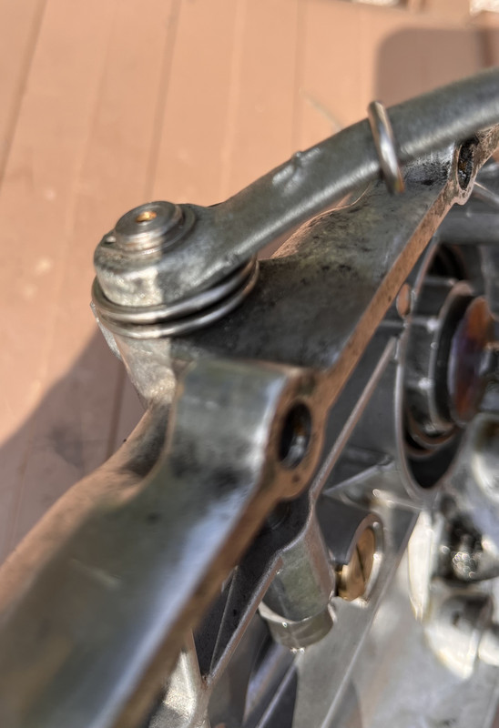

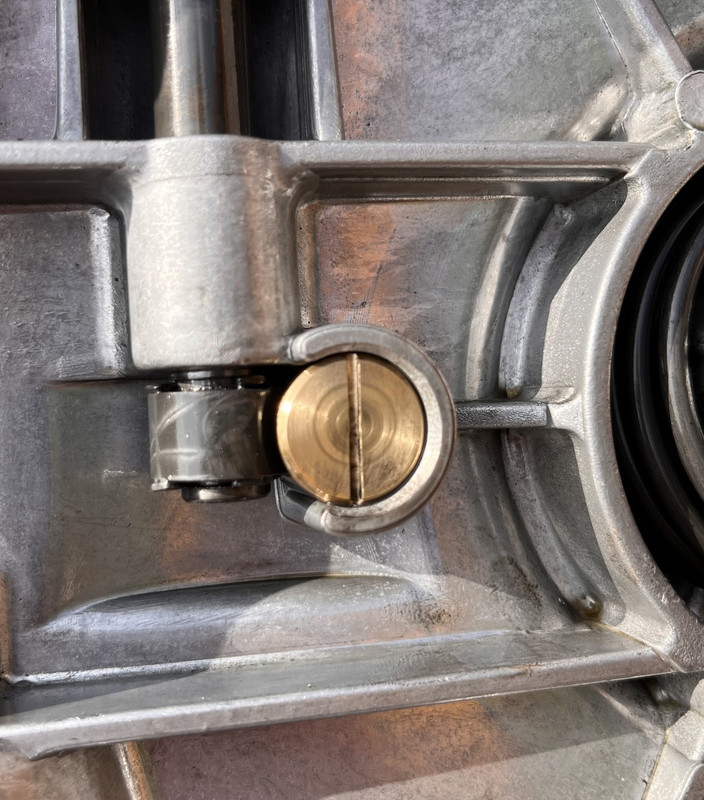

On the issue of the light grinding noise I have had since the engine was built, I may have found what it is.
You can see a noticeable witness mark on the brass clutch thimble. It has been spinning against the top of the clutch when the clutch is not depressed. I think this is because the shiny stainless spring on the clutch lever is poorly formed causing the clutch thimble to jam open in the casing. I have bent the spring in a vice in an attempt to make it activate cleanly and return to its original position when the clutch is not depressed.
Time will tell.

Postby hullygully » Thu Jul 13, 2023 4:48 pm
hi bud, it shouldn't spin cos it should be captivated on the operating finger

as the selector is protruding past the layshaft, is it also protruding past the first gear making the shim rub against the endplate? :shock:
Posts: 2443

Postby Storkfoot » Thu Jul 13, 2023 5:27 pm
hullygully wrote:hi bud, it shouldn't spin cos it should be captivated on the operating finger
:D

hullygully wrote:as the selector is protruding past the layshaft, is it also protruding past the first gear making the shim rub against the endplate? :shock:
Yes, I am pretty certain that has been happening which is why the shim is a right mess.

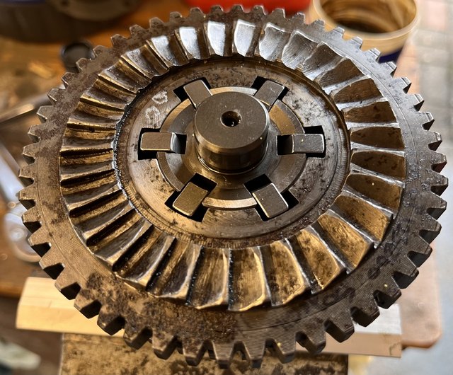

Postby Storkfoot » Thu Jul 13, 2023 6:58 pm
This attempt is the same Layshaft (A), a new FA Italia gear selector and an Italian GP200 first gear.
The gear stack clears the Layshaft by 0.08mm. I think that’s probably okay. The selector, when in first gear, stands proud of the first gear by 0.04mm. That sticks out less than before and, provided it shims up okay to something nearer 0.30 than 0.07mm, it may be okay.

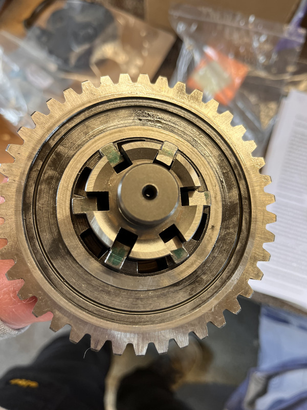

Update:
This was the gear selector when I picked it up, having had .08mm ground off. As you can see, this hasn’t touched all the prongs.
I put it all back together. It appeared to shim up fine with a 2.00mm shim but I still have the same issue. It remains difficult to engage first, is a bit clunky between second and first and there remains a bit of a grinding noise. On the plus side, it is a bit better than it was so I believe I am on the right track.
It needs to come apart again so I can have another go. This time, I am going to take the gearbox, Layshaft and gear selector in to the engineers to explain that 1. The gears need to stand proud of the Layshaft by 1.00mm; 2. More needs to come off the gear selector.
I am also awaiting delivery of an Italian Li125 second gear which is the same as the GP125/200 second gear. I suspect that the current second gear may be Indian.
