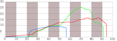

I think this is interesting. It's on a slightly tuned gt186, so can probably rev higher than yours but still, it's a useful comparison.
The clubman is in red and the standard one in blue.
Worth noting that a standard pipe out-performs the clubman up to about 4000rpm.

Cheers all, I presume that graph comes from the Scootering test a few years ago. I've re read it a couple of times now however, a new exhaust will have to go on the back burner as removing the old exhaust revealed a couple of studs sheared off at the chaincase face. As they were flush I couldnt use a stud remover so resorted to drilling and using LH stud extractor bit. Would they budge, would they heck (even with plenty of penetrating oil etc), suffice to say I then managed to shear the bit off again at the chaincase face so back to square one with getting the damn things out !!!

And yes, it is from scootering magazine.
