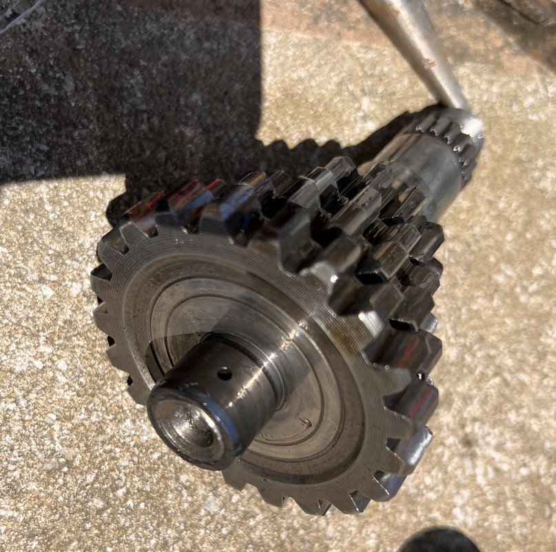

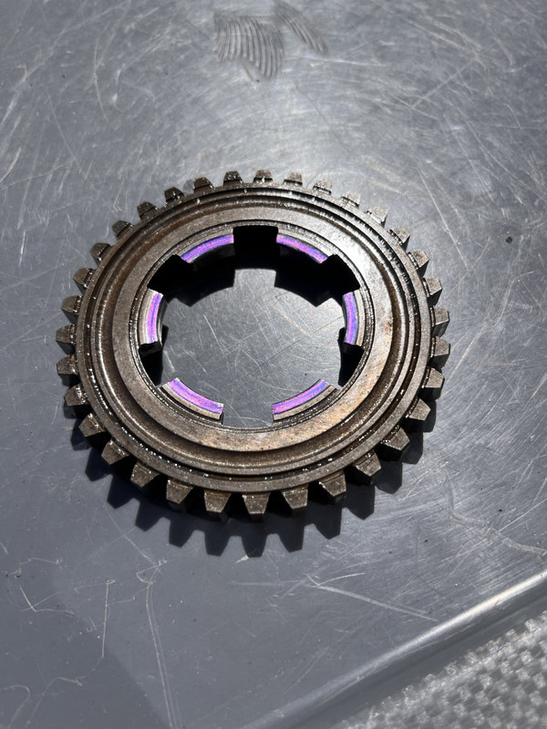

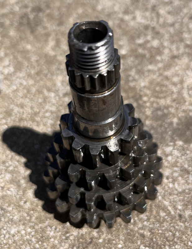

About 2006, I bought a battered 1962 Li150 engine. I bought it for the gearbox mainly. The gearbox found a new life in my TS1 for the past 13 years but, just before my Eurolambretta trip, I had the gearbox out. I then spotted how battered and worn it was. Without any time, I put it back in.
Oddly, first gear is okay but third and fourth are worn out, as is the Christmas Tree.

I've never experienced anything like this issue, nor can I recall it occurring to my knowledge.
IMO the OEM Italian & Spanish gearboxes were very good, not only for their original design intent but their capability beyond that. I do have experience of other gearbox components failing upon first use, including AFR, DRT & SIL because in all instances they were too hard & consequently brittle.
I can't help wondering if @ some stage the oil level has been insufficient for the loose third & fourth gears to have been able to circulate sufficient lubricant to prevent wear. First & second loose gears have the benefit of being larger in diameter & therefore are the last to be affected by any drop in the oil level.....

It wouldn’t surprise me if the gearbox had been run without oil before I got hold of the engine. The engine it came out of years ago was a mess but I got it cheap just to get the gearbox out really. I had the pitting attended to with a sleeve and then have just used it ever since. I’d never noticed the extreme wear to third and fourth until I examined the gearbox properly last month.

Was it side on wearout or was it like playing hoopla when stacking on the layshaft?
When I stripped an engine with TV/SX box not so long ago the third and fourth waggled around when I slid them on.
Massively worn round the centre, and I wondered why it jumped out of fourth..

A bit of everything really. Generally, very worn out.
The worn out gearbox is still in the engine with the new selector spring. It jumped out of first gear but it is 3rd and 4th gears that are worn down. The new selector spring has remedied the jumping out of gear but I am sure it is only a matter of time before another problem manifests itself.
