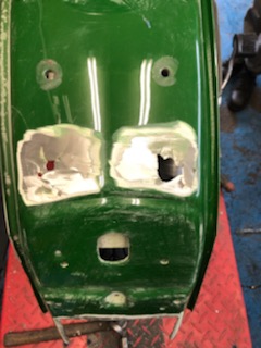

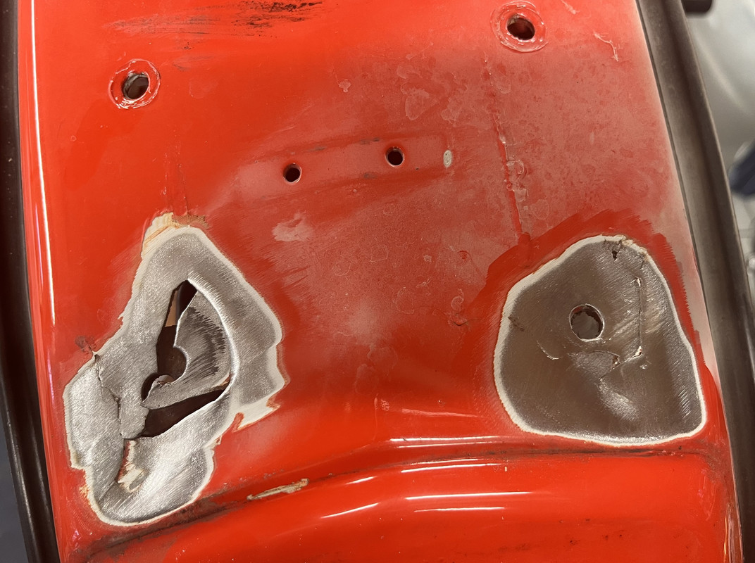

It first started going like this in 2015 on the way back from Bannockburn. I lost a nut off the rack on the way home. Since then, I have just touched up the paintwork every now and then when really I should have sorted it out :roll:

Thanks, Rich. As I suspected, the spot welded support underneath will need knocking out first.

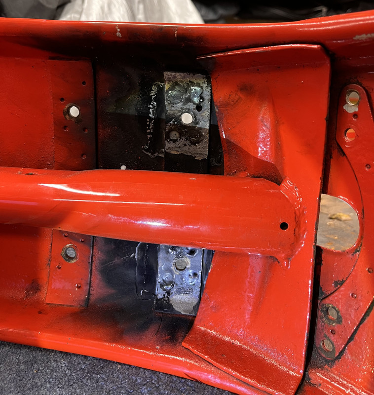

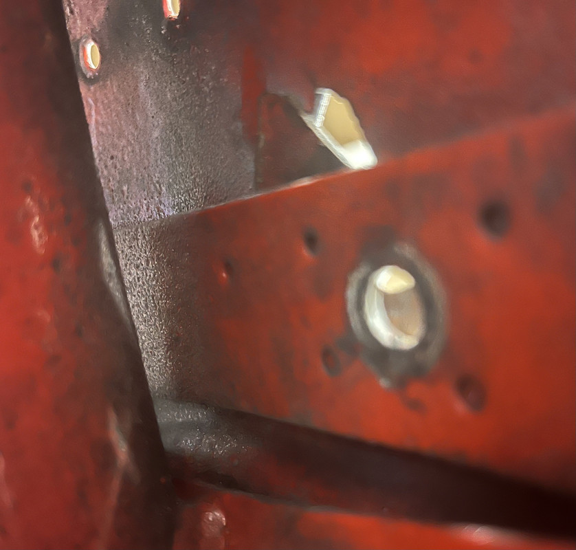

Postby Storkfoot » Tue Nov 19, 2024 6:30 pm

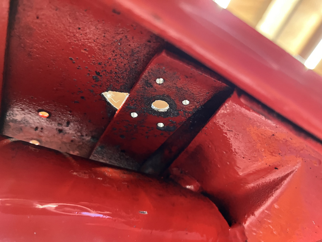

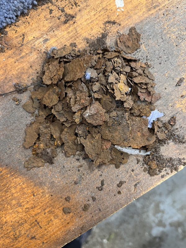

I have stripped the scooter down to just the frame and legshields ready to get this fixed. I also took a minute to drill out the spot welds. The vibrations from the drill brought a rather large pile of rust out from the middle of the tube :roll:

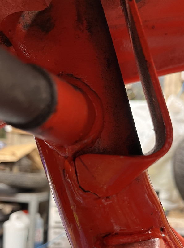

Oh, and I also have another fracture needing welding

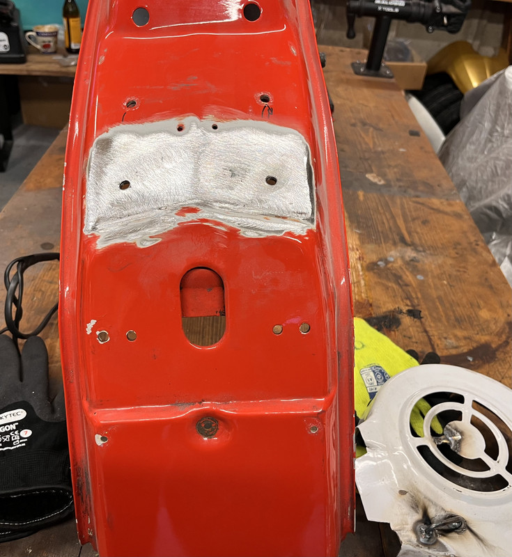

Postby Storkfoot » Thu Dec 12, 2024 10:20 pm

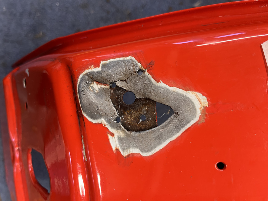

I now need to decide how to try and stabilise the rust in the frame before the frame goes for the repairs to be painted in the new year.
Re: Heavy luggage takes its toll
Postby Rich Oswald » Thu Dec 12, 2024 11:07 pm
Looks good that Paul.
