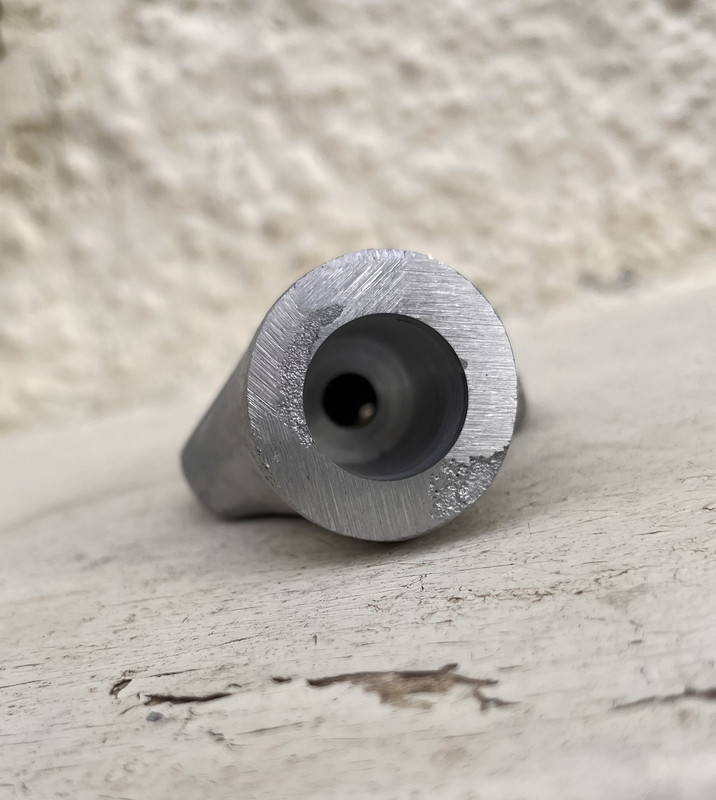

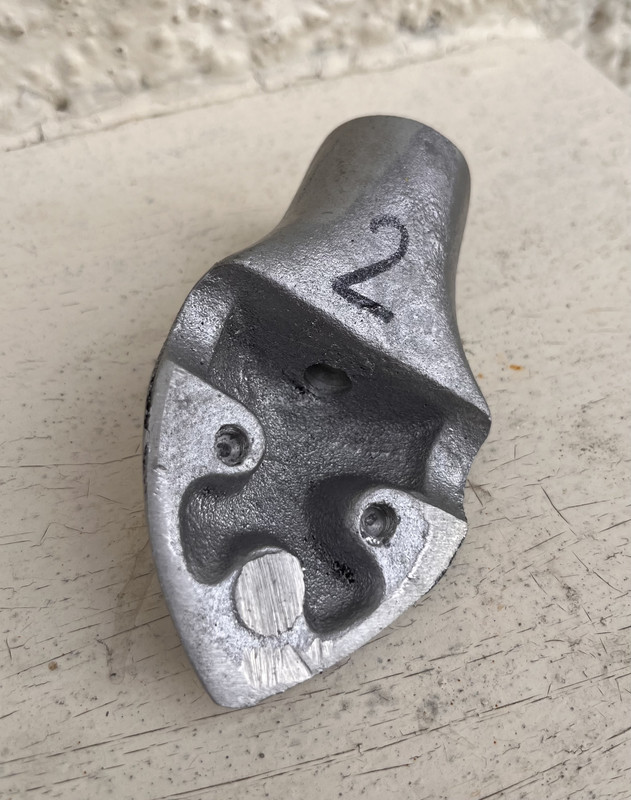

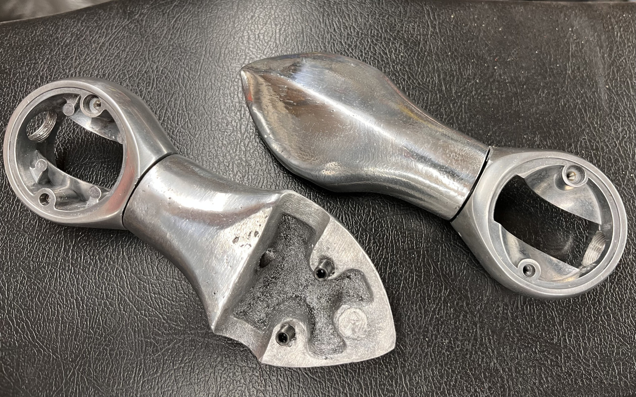

Now I have had the cores of the housings drilled out, I thought I’d start a thread about the indicators I have fitted to my Series 2. Over the next few months, I’ll go back through what I have done and what I am changing.
This is the the Series 2 that the resin versions are currently fitted to:
viewtopic.php?f=19&t=15144

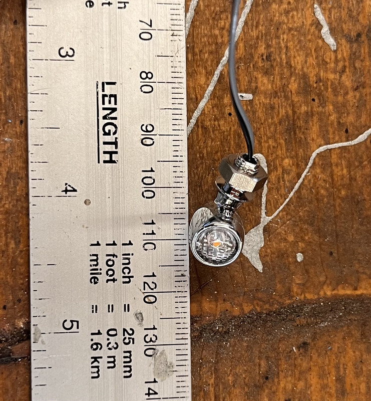

I have decided that I really need indicators at the back too as, from behind, vehicles can’t always see my legshield indicators. Initially, I was going to go with something more in keeping with the originals, however, I have now decided to go with unobtrusive LEDs. They would probably look good front and back on some Series 3s.

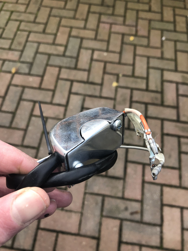

Going back to the start. This is the Honda C90 switch as it arrived.
It’s a simple switch with three wires. An orange to the right hand indicator, a light blue to the left and a grey to the flasher relay. Given that there are still so many C90s on the road, there are plenty of remade ones out there. It provides a reassuring “click” when it engages left or right which you can feel through thick gloves.
That said, it is designed to attach to motorcycle handlebar, and so, it needs a lot of work to get it to fit to a Lambretta handlebar. I wanted it to be operational with my right thumb so I didn’t have to take a hand off the handlebar when operating the indicators.
I bought a 4 pin flasher relay along with the indicators themselves and mocked it up on the bench. I even included a Vespa T5 type buzzer and a warning light to be visible in the handlebars. It all worked but I didn’t notice at the time that the indicators flashed too quickly and that I didn’t really need the warning light or the buzzer as I could see the indicators flashing from my riding position.
At this point, I sent the switch away to be modified.

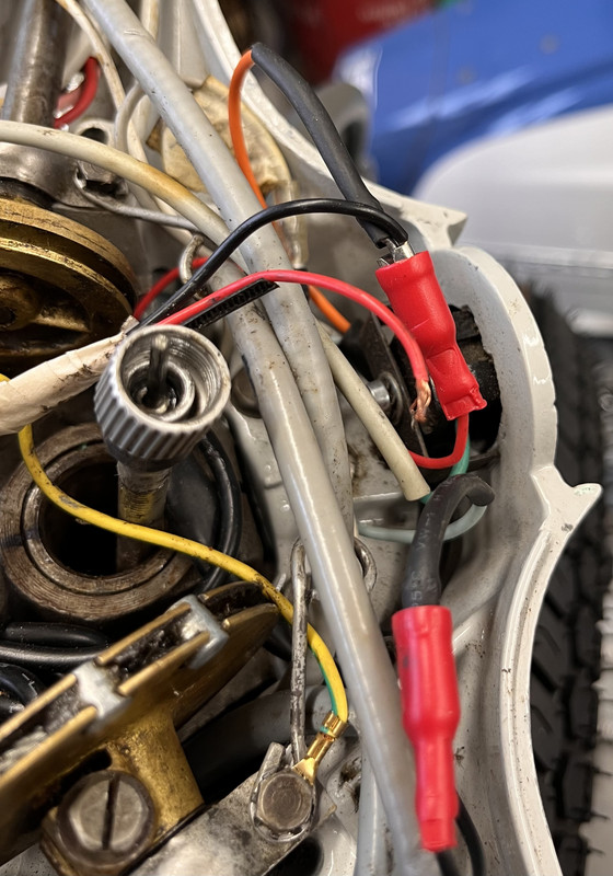

Postby Storkfoot » Sat Nov 09, 2024 3:02 pm
It turns out that the problem was a simple disconnection of one of the rear indicator wires in the headset. It meant there was no connection from the switch to the left sided rear indicator.
The headset wiring is a bit busy as I also have my Tom Tom wired into the lighting circuit.
Now I have operational rear lights, I updated my wiring diagram.
At this point, once again, I’ll reiterate that I have a very limited knowledge of electrical circuits :D

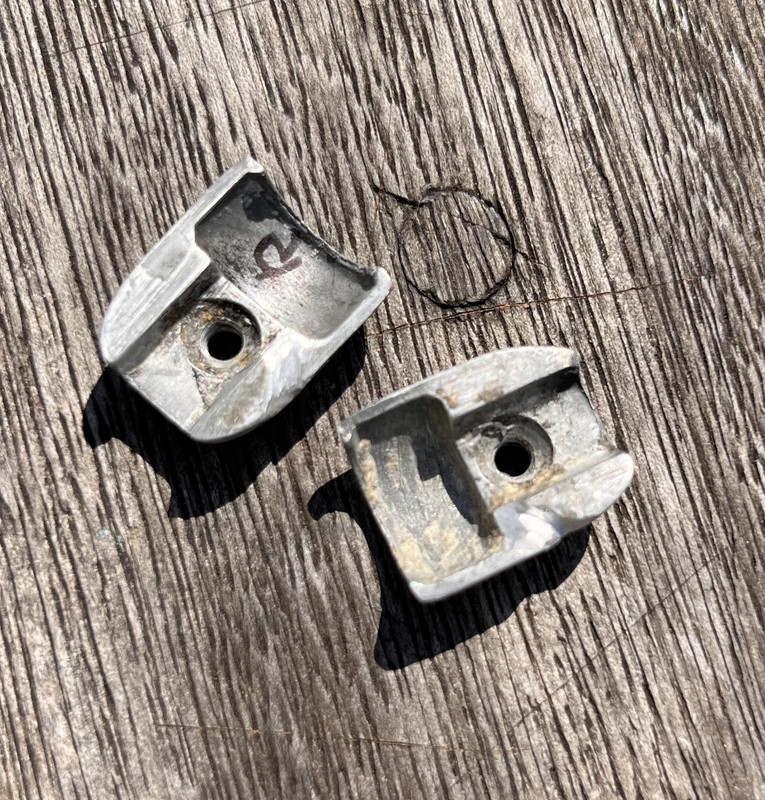

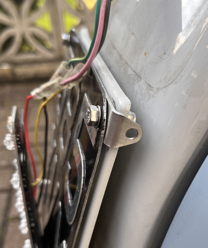

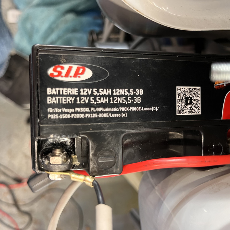

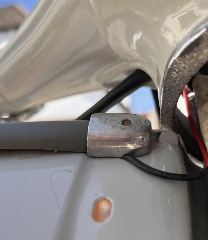

Here are a few more photos showing how I routed the cables behind the legshield beading and out into the headset to connect with the switch wiring and rear indicator wiring. I have also included pictures of the battery, connectors and adjustable flasher relay. Oh, also the switch as I got it back from being worked to fit a Lambretta headset.

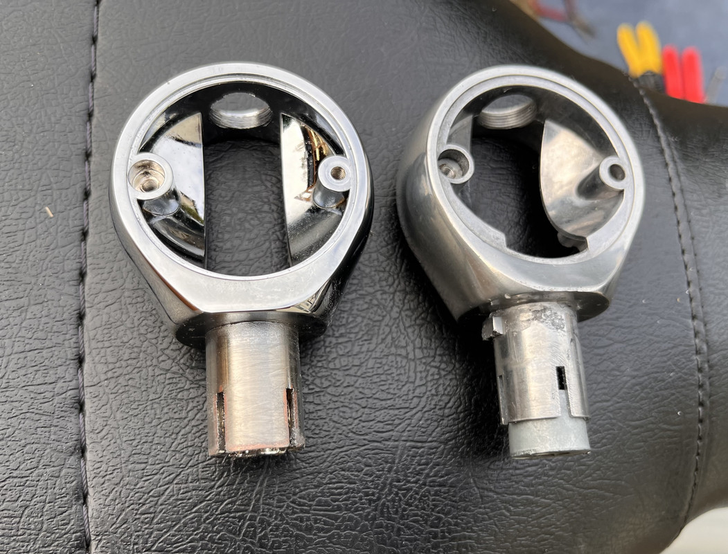

Postby Storkfoot » Tue Nov 12, 2024 11:13 pm
I could spend forever polishing and more polishing but this’ll have to do.

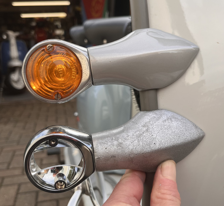

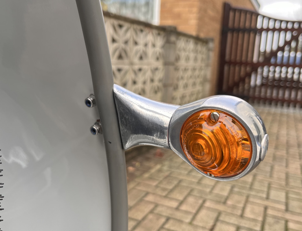

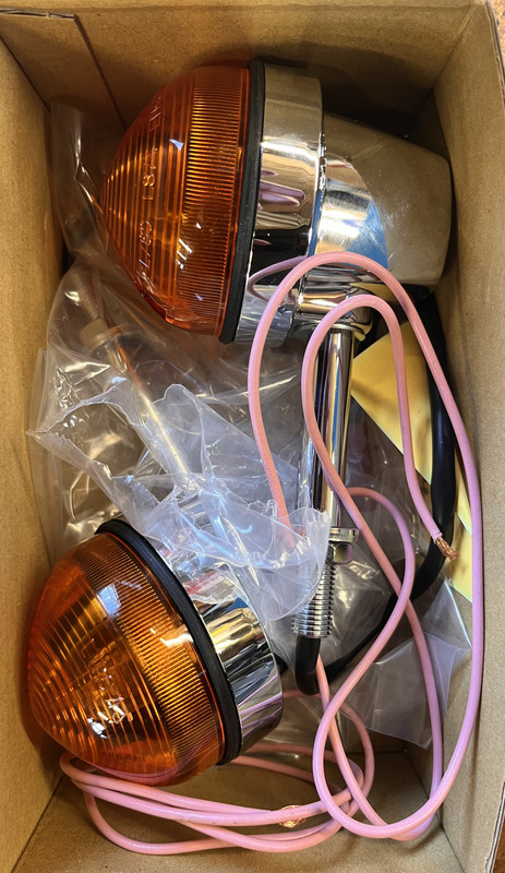

Originally, I’m unsure precisely what indicators were used with these housings. They look like they were just a bulb enclosed in a plastic lens. The ones I have used are bar end indicators from BMW motorcycles apparently. They are pretty sturdy. In the photo of the two of them, the Hella ones are on the right, the copies from eBay are on the left. There is little material difference.

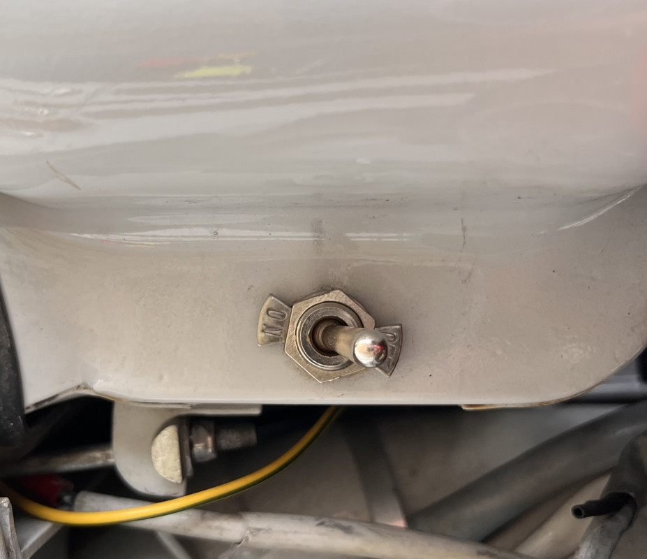

There’s also a picture of my battery isolation switch. I put this in as I believed that the flasher was slowly draining the battery. Since I put it in though, I have hardly used it so I am not so sure it is really needed. That said, I shall use it more over the Winter.
