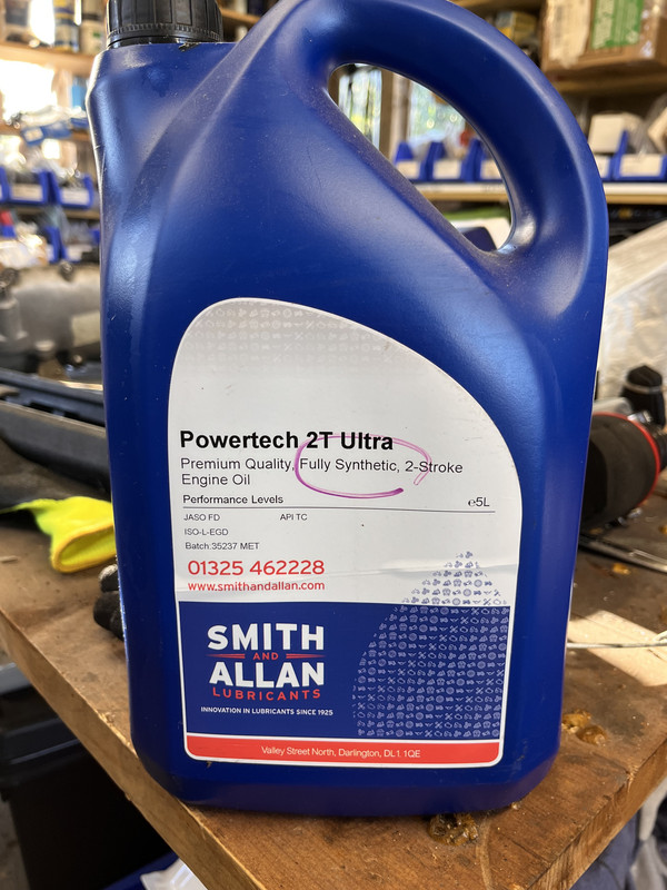

That is really interesting. I am not using Motul 8000 but I did think that the petrol colour in my petrol pipe was rather red tinged (the oil is red). I have been using this oil but not for very long :idea:

I have just checked the spec for the Smith and Allan oil. It says injector and premix.

I am fairly convinced that my oil is an issue and that this has kicked in as the weather has got colder. If I think back to me running around to jet the PHBL25 in, I do believe that I did have issues with lean running in the first couple of miles when the engine was under load going up a hill. This would clear after a while. With hindsight, I did see pockets of red oil forming in the petrol pipe too.
Initially, I put the poor running down to the cast iron barrel still being cold but even when I left it ticking over for ages, I still encountered that feeling of fuel starvation in that first couple of miles. After that, the engine ran much better.
I’ll drain some of the tank into a clear plastic bowl tomorrow to see if it does separate.
