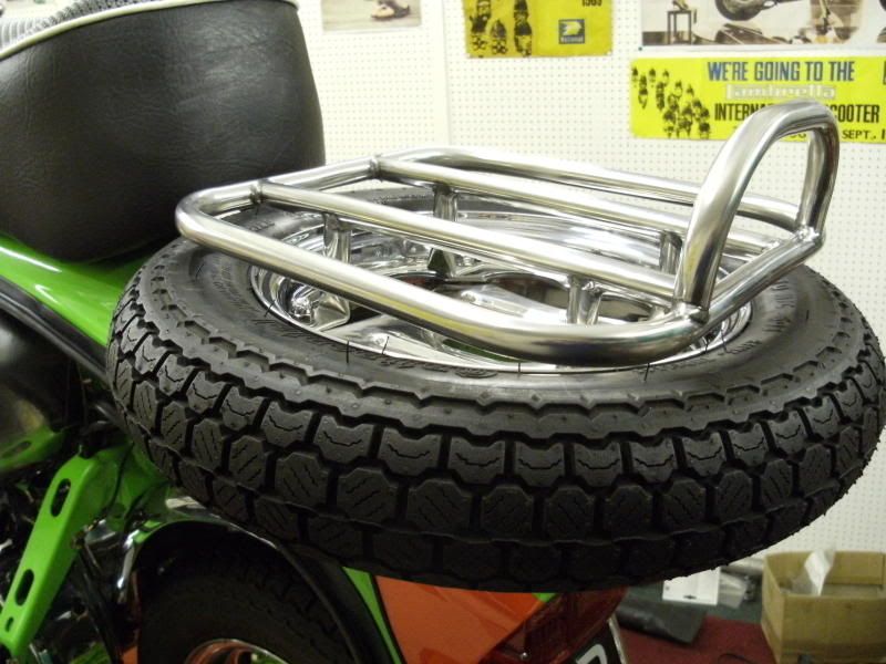

Postby peejay » Sat Nov 22, 2014 7:01 pm
i suppose any bracket fitted can damage the paint
this is ok for about 20 lbs without upsetting the handling at all (that's a lot of T shirts) :)
Re: luggage rack
Postby northernpete » Tue Nov 25, 2014 7:54 pm
Peejay......can you tell me where you got the rack from? Got spare wheel holder like yours and wanting to add rack like yours.......Thanks!
northernpete
Posts: 108
Joined: Fri May 30, 2014 8:29 pm
Re: luggage rack
Postby peejay » Tue Nov 25, 2014 10:31 pm
northernpete wrote:Peejay......can you tell me where you got the rack from? Got spare wheel holder like yours and wanting to add rack like yours.......Thanks!
hi Pete
got this one in 2009 from Rich Presley, great quality :)
