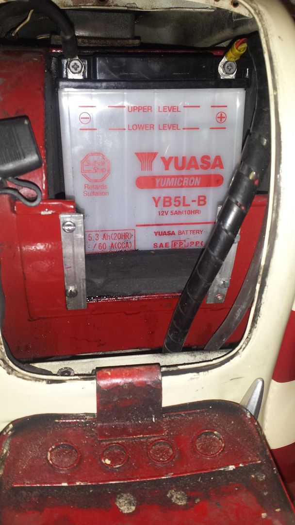

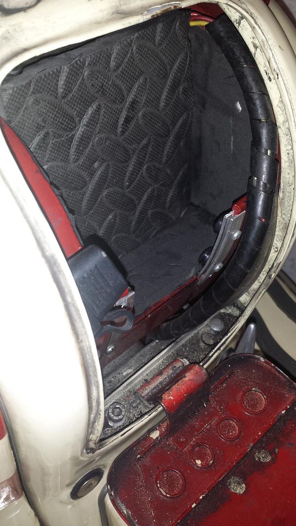

This is what I use in my diablo. I run full DC.
This is how much room I've got left with foam padding in front of battery. I know some struggle to get the battery out so I cut a bit out and fitted a sliding piece.

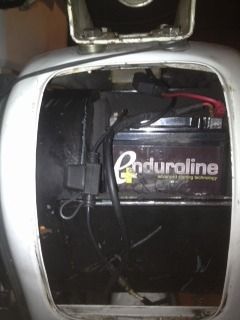

Wack, here's mine also in a Diablo tank , it's an Enduroline YTZ7S, been great, I always trickle charge it . I'm full DC. Oh and it's 6 ah
