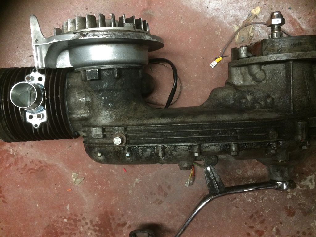

I was helping a mate with a rebuild of his engine today he's fitting a BGM pipe Dellorto 28 PHBH and we were going to mildly re-port the barrel and we were also fitting a new mag housing crank and drive bearings.
All the new bits were had arrived but half way through the work we realised we didn't have the large circlip for the mag bearing, so I remembered that I had an old Li 150 engine, and I thought I would take quickly take it apart and get the maghousing off and use the circlip.

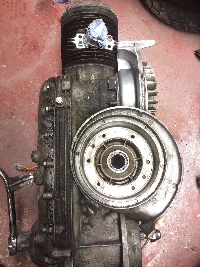

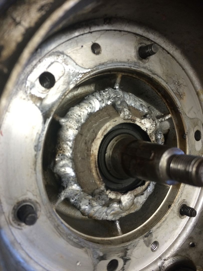

When I took the flywheel off the Li engine this is what I found.
:shock: :shock: :shock:
Not exactly what I was expecting. Even the outer seal has been put in back to front. Up date was that it did at least have a usable circlip 8-)

Hell fire, that's some bodge that!

On the basis of its not pissing oil I would call that fixed. Not prety. Have we all gone soft in our old age. Remember we fixed these ruddy things with bed scanners and tube spanners that you hit with a hammer to make it fit. Tig welding what's that

I don't think its air tight, and both seals in the maghousing were in back to front.

It most probably cost more in time and money welding it than it would of cost to buy a new one

modster79 wrote:It most probably cost more in time and money welding it than it would of cost to buy a new one
That's exactly what I said when I saw it, thinking about it now that was the second thing I said... After WTF :lol:

There are bodges/quick fixes some permanent some temporary same with cars. If that doesnt leak and works ok ,obviously not the correct way to do it but i'd call that fixed, a bodge would be P40 or JB weld and the like. Most likely done at some point in its life at a time when no used parts were available.
