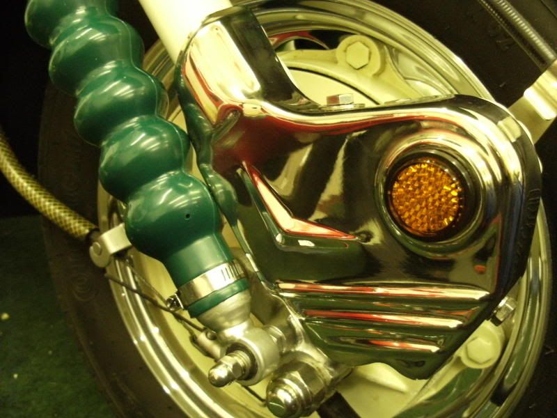

Postby peejay » Wed Jun 17, 2015 10:06 am
this is the easy way:
no need to strip forks down, simply slide over fork link bolt and slot fixing holes where neccessary and secure with penny washers, cover large hole with stick on reflector, simples :D
ps: easy to remove to clean paintwork.

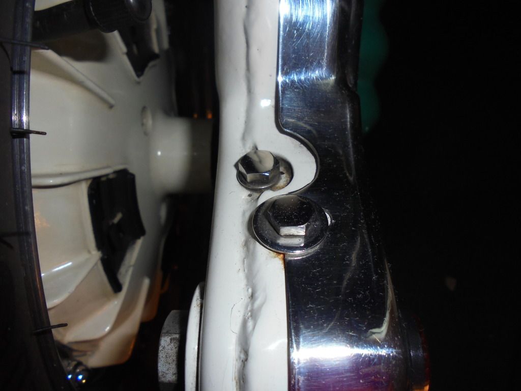

Postby kennystag » Wed Jun 17, 2015 11:49 am
Hi Mate,
Thanks for getting back to me, the problem I have is there is no bolts to put a washer on, to hold the covers in place. Do you think putting sticks like shit or similar would hold them on.

Postby peejay » Wed Jun 17, 2015 2:53 pm
hi Kenny
i'm not sure that sticky tape alone would be enough in this case because of the large protruding bolt head, maybe with GP forks the link bolt has to pass through the hole to secure :roll:
