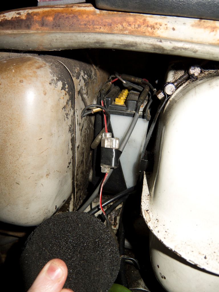

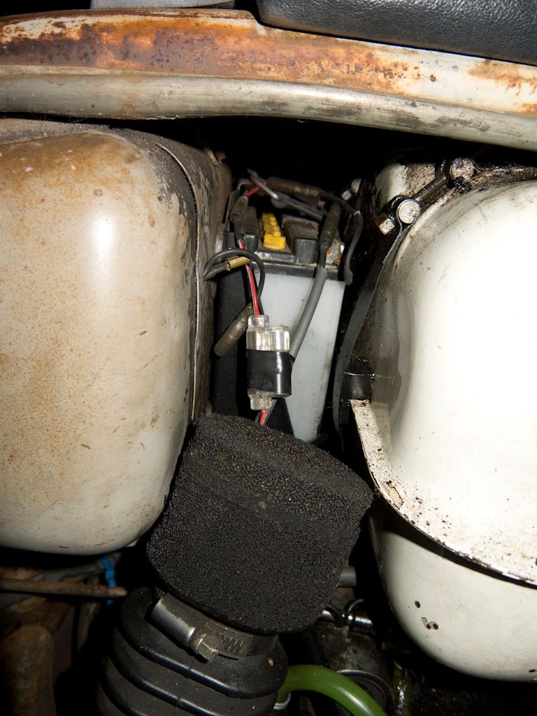

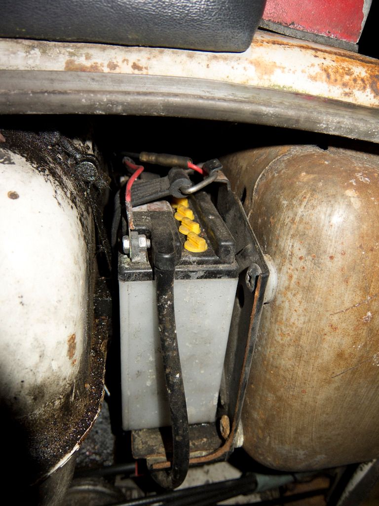

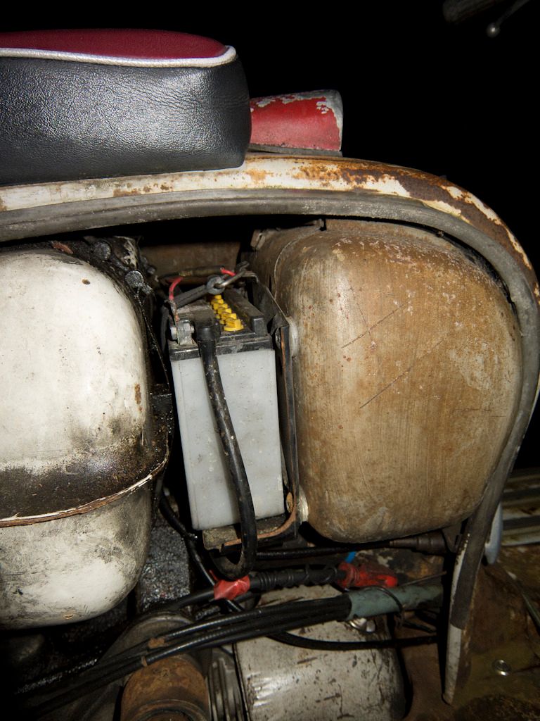

Postby Nelly » Thu Aug 27, 2015 8:59 am
terryj wrote:have seen a post on ere somewhere were the battery was fitted in a box on the rear mud guard
as for doing the wassel i am a complete idiot when it comes to electrickery and i found it a doddle
change 1 wire of the stator join up wassel and wassell to brown in loom and fit battery job done
It was my post showing where I squeezed the vespa battery tray over the rear mudguard a few months ago.
download/file.php?id=453&mode=view
This works well and gives loads of power.
You can also see the Wassel alongside the battery.
Hope this helps.
