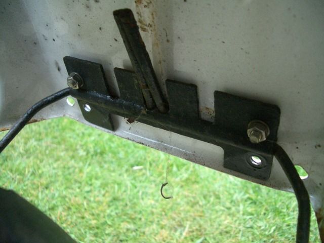

Hello,
I have recently purchased a scooter on the internet. The side panels were not fitted and I had to purchase some springs. I wonder if someone could be good enough to take a photo of their GP/DL springs from the inside showing how they sit/attach in the metal bracket when the panels are not on as I seem to be having some trouble (I think there is some warping of the area where the number plate goes on). Also if you could take a photo of the spring sitting in a panel (like through the bike from the opposite side) that would also be really helpful!!
So many requests on my first post!!
Cheers!
Rent Peaple

Postby TurboTrev » Wed Oct 07, 2015 4:18 pm
TurboTrev
Posts: 149
Re: GP Side Panel Springs
Postby Rent Peaple » Wed Oct 07, 2015 5:15 pm
Thanks for the replies and thanks for the photo TurboTrev.
I already have bought the stainless steel ones unfortunately, but will take what you say on board and possibly change them out in future.
That's how I thought they should sit, but I haven't been able to stop them crossing in the middle, I think there is too much room for them to move around. I am heading out to the garage to work on it with the rubber hammer!
Postby Toddy » Wed Oct 07, 2015 5:34 pm
You can cut out a bit of rubber to fit between the bracket and frame makes a better fit

Postby rossclark » Wed Oct 07, 2015 7:05 pm
You can bend the middle ends out a bit to stop them crossing and the definitely should be a strong sprung fit into the lip on the panel. It should be strong enough to pull the panel down into the arch slightly and secure it firmly.
