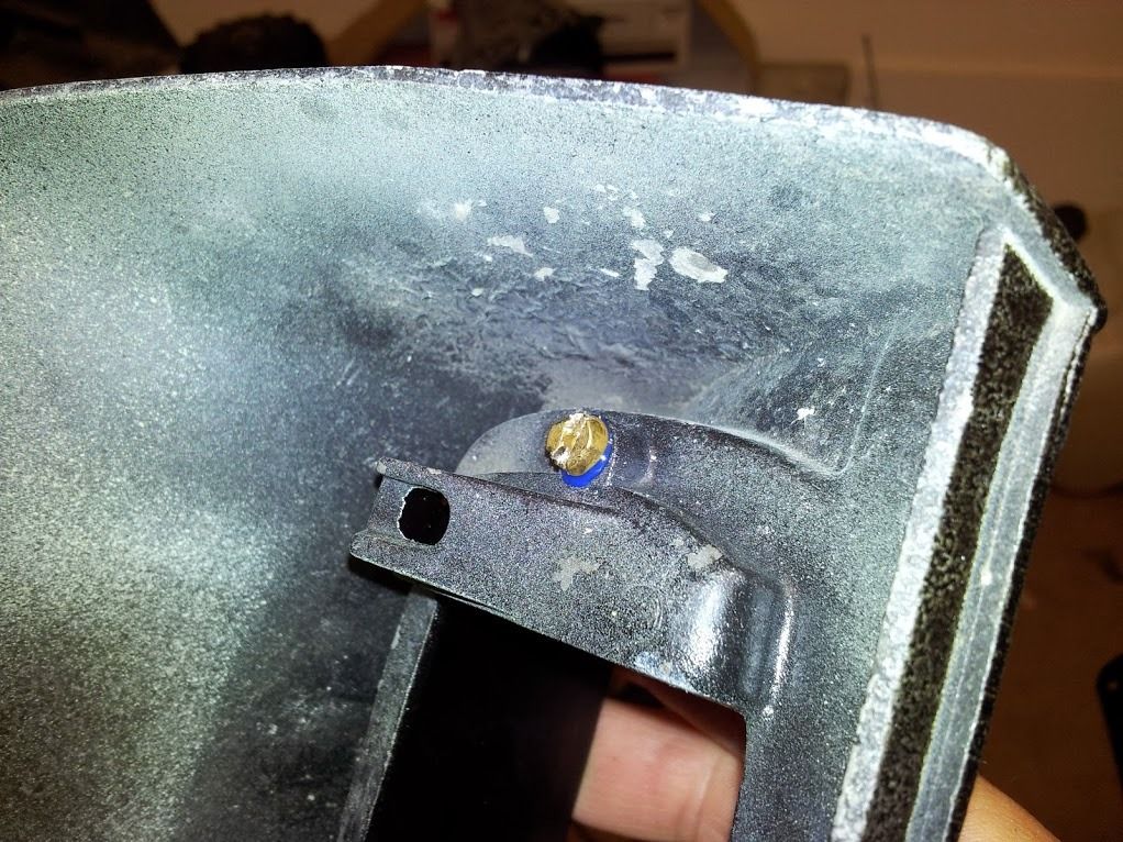

I found a use for an old jetex jet :D ...drill out to m5, loctite in, then re drill and tap :)
