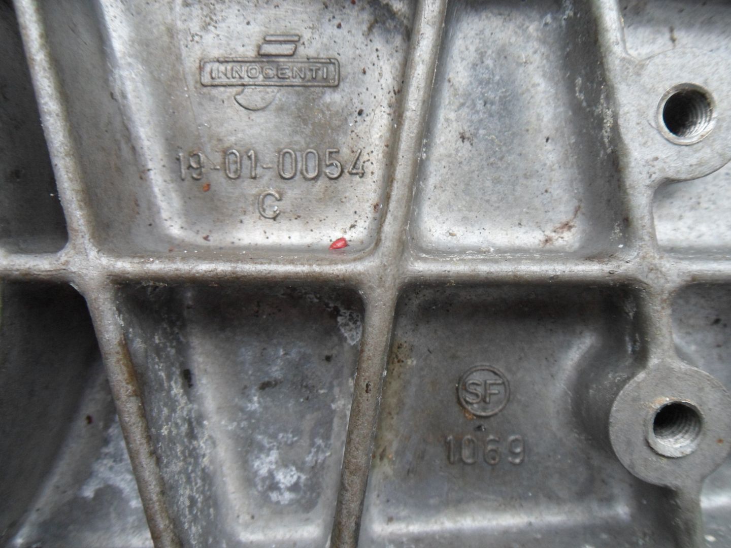

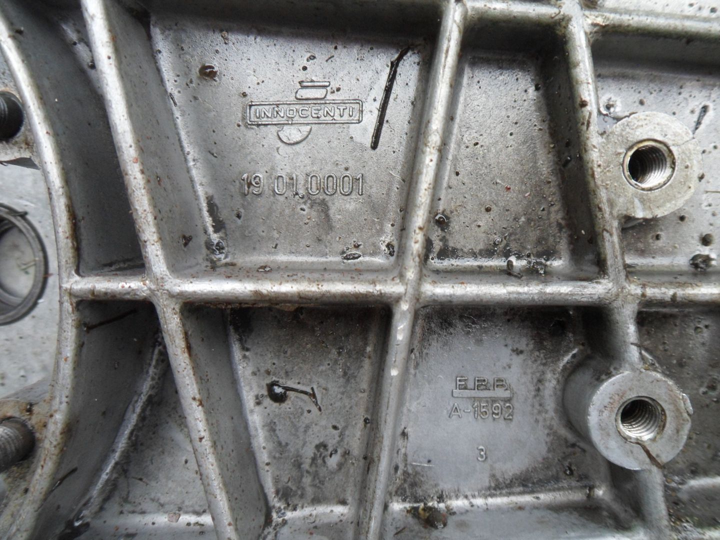

Postby lammydave » Sun Nov 08, 2015 1:26 pm
One I have of three that are like this
the one in question
Stampings inside "standard"
"Other" stampings
as you can see, different part numbers and the lower stamping is different (supplier??)
Indian, Spanish? Italian?
lammydave

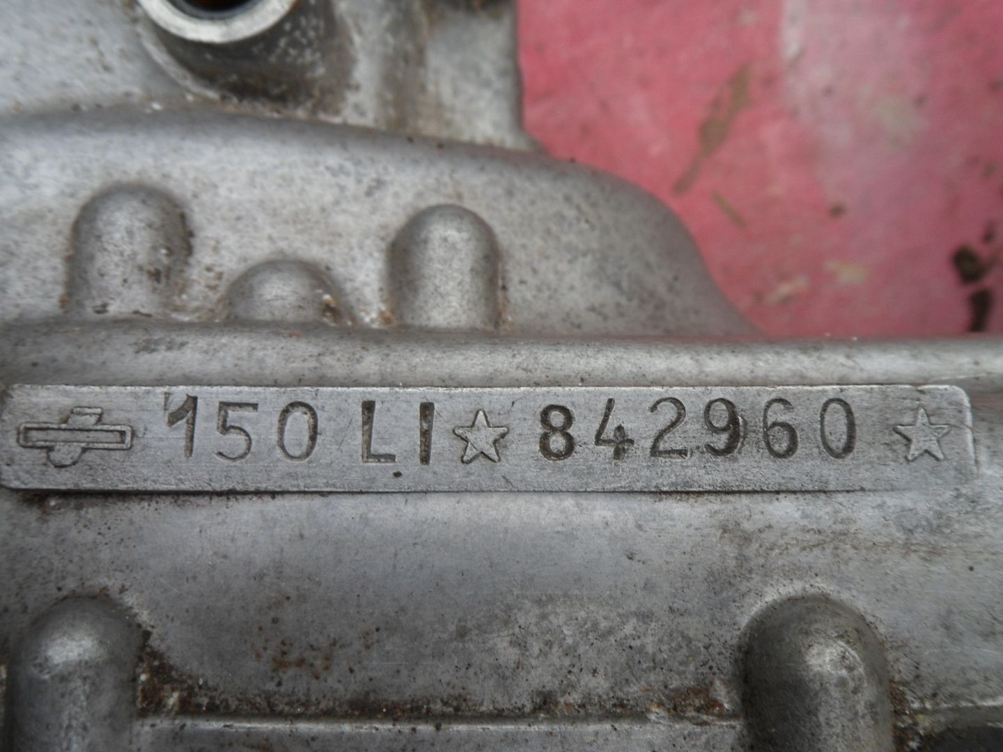

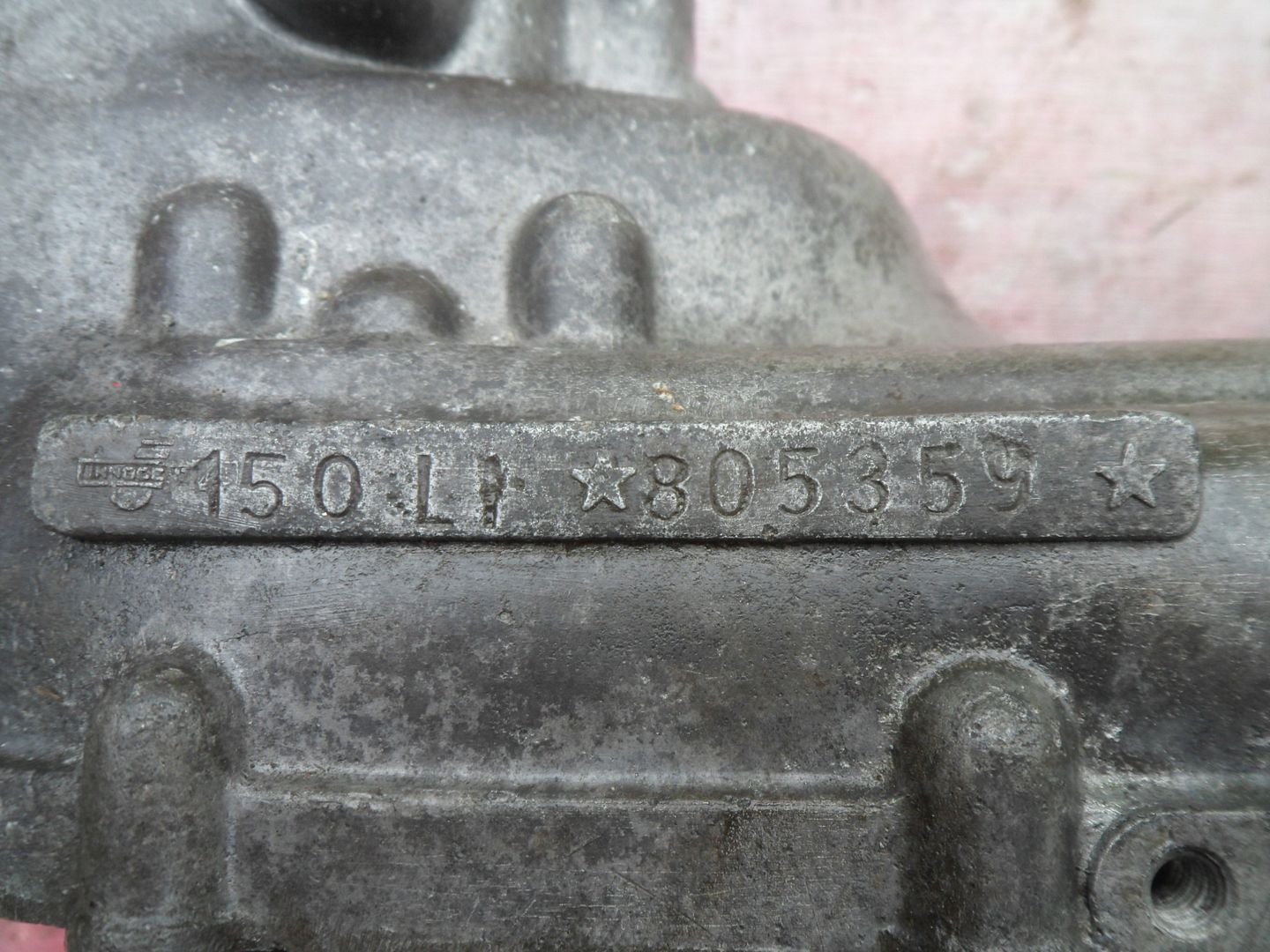

Postby landybretta » Sun Nov 08, 2015 3:17 pm
Not sure if this helps but if they were Italian then engine number 150LI 805359 would be from a 1959 series II and engine number 150LI 842960 would be from a 1960 series II.
However I cannot find either of the parts numbers listed in any of the Italian parts manuals for the crankcase.
But with Innocenti records anything is possible.

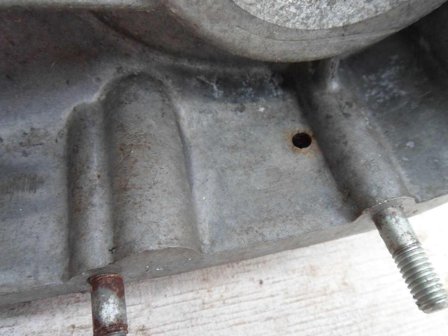

Just to add a bit more mystery.. the earlier one is like this underneath, with the extra mounting lug for the exhaust (although some muppet has drilled the front one and gone thru the crankcase!!
lammydave
Posts: 233
Location: in the shed

Postby landybretta » Sun Nov 08, 2015 9:07 pm
As far as I am aware the LI 150 Special frame was stamped LIS but the engine was stamped LI 150 (no S)
landybretta
Posts: 730
Joined: Thu Jun 05, 2014 10:22 pm

Postby rossclark » Sun Nov 08, 2015 9:37 pm
Those look like Italian casings from different foundries.
Spanish usually don't have the Innocenti cast in as they seem to have had their own moulds.
This is SIL Indian and has it as they're cast from adapted Italian moulds.
Don't know about other Indian sources as I've not handled any of those.
