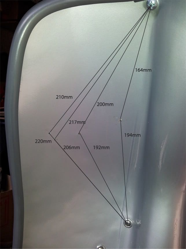

the painter in the unit next to mine has a Silver Special in at the moment
new legshields were needed, they come without any holes for the badges.
is there a template available anywhere ? I thought there was something on rimini site, but can't find it now...? I haven't got anything in at the moment to take any measurements from
thanks

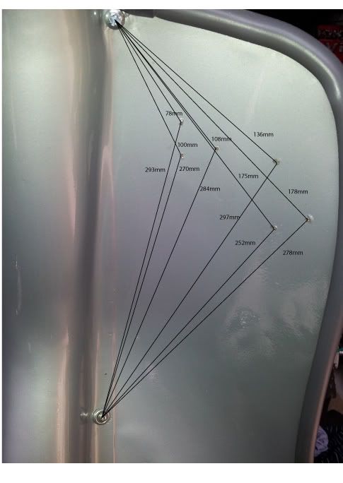

Postby carlos fandango » Sun Nov 22, 2015 12:14 am
I did this a few years ago off a silver special i had
They were afaik original holes positions for a silver special , but dims would change slightly if the leggies are miss shaped ?

Postby byron » Mon Nov 23, 2015 5:22 pm
byron wrote:...will pass that on to the painter
who asked if I could do this; so before I start drilling... did you measure these across the metal of the legshields, or are are they straight lines using a caliper ?

Postby foremanbob » Mon Nov 23, 2015 6:20 pm
just to be the purveyor of gloom and doom... do the pins on the badges you have match up with that?
Personally I'd use these a ballpark positions and mark for drilling using the real badges.... especially if its at the painters just now...

Postby byron » Mon Nov 23, 2015 7:49 pm
foremanbob wrote:... mark for drilling using the real badges....
yep, worthwhile point, but it's all good, the new badges to fit are with the painter, so will be using them to check hole positioning.

Postby carlos fandango » Mon Nov 23, 2015 9:35 pm
Straight line with a caliper .
It would of been better to measure on the front of the leggies following the curve with a tape measure, as this would of allowed for any distortion in the leggies . The scooter was complete and I didnt want to take the horncast off to use the holes as datum points , so it was easier to do it off thr screw haeds at the rear. As such it wont be completely accurate, but should get you in the right area :)

Postby byron » Tue Nov 24, 2015 10:50 am
carlos fandango wrote:Straight line with a caliper .
brilliant, I was expecting and hoping you'd done that, should be loads easier to replicate. thanks again Russ

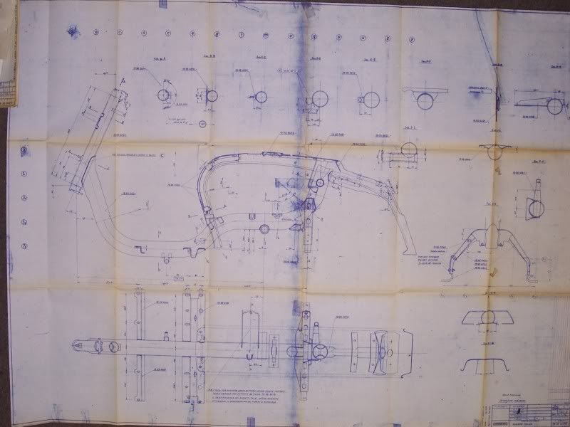

It would be good if we had a library of things like this on the forum , maybe in the members area ?
Im thinking of badge hole positions for all models, ink splat position etc. Frame dimensions and lots of other std stuff :)
carlos fandango
Posts: 244
Re: legshield badge positioning
Postby Wack » Wed Nov 25, 2015 7:18 pm
And some good quality frame dimension blueprints :)

I just thought to keep the information for the payed up members ......but I suppose with the way t'internet works it wouldnt stay in the members area for long .
I know the scootopia have a set of original blueprints , and I suggested to them that it would make a great poster :) but they said they weren't interested in doing posters . I assume they dont want them freely available , as they use them for their remade parts . I was also told that lcgb hold a copy of the blueprints ? but this hasn't been confirmed ?

Postby Wack » Thu Nov 26, 2015 7:47 pm
I wonder if Vittorio has some blueprints and would consider a poster?
