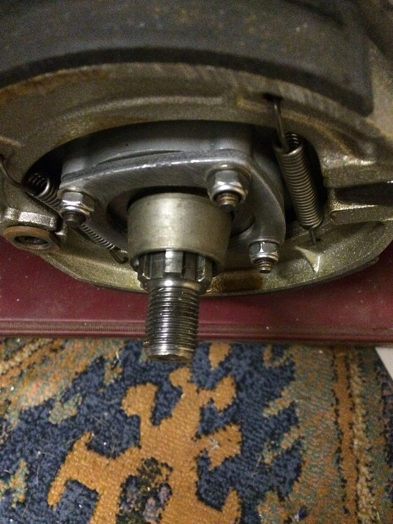

Can anyone tell me if there is a specific amount of spline that should protrude out of the cone on a series 3 layshaft,,as I see you can but various thickness shims.

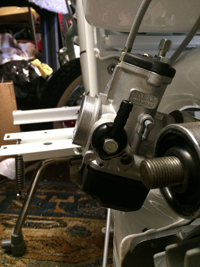

I have fitted a 200 Muggy and it came with an inlet manifold,but the carb isn't sitting level,its on quite an angle,which doesn't seem right to me.

If the splines reach almost through the hub, then you have enough. If the splines are level or protrude the you have too much. The hub cone fits with the slot over a spline. I didn't think the shim under the cone varied however there are various shims at the gearbox end to allow adjustment.
What carb are you using? A slight tilt on standard carbs is ok.

carb at an angle is a very common problem. some manifolds are ok when series 1 & 2 engine mounts are fitted but on series 3 they can be miles out, over the years i've had to "mod" several manifolds with this problem. if you are lucky the holes can be enlarged a bit but i prefer to do a "cut & shut" job on the manifold to bring the carb away from the mount so that the carb can be rotated a bit to get it on or off.

Hi guys,sorry,it 26mm Dellorto.I will post a pic later,of the carb and the splines.

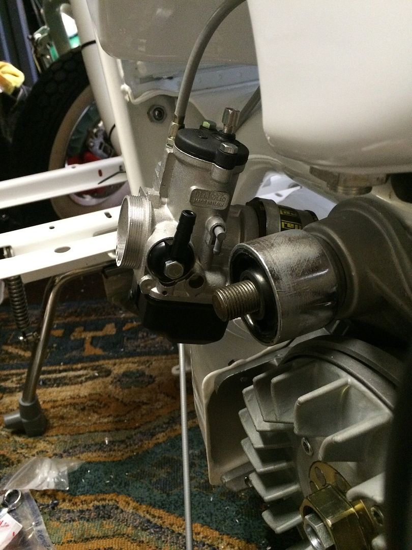

Postby dave411 » Sun Dec 06, 2015 3:24 pm
Here you are.What do you think?

Postby peejay » Sun Dec 06, 2015 3:37 pm
hi Dave
i thought you were talking about a standard carb manifold.
i've never understood why a big carb is fitted at such an angle and refuse to do it on my scoots. surely the float bowl is going to have very little fuel in it. i've made my own manifolds so that carbs are upright and level just like the original ones were.

Postby Adam_Winstone » Sun Dec 06, 2015 4:10 pm
The angle of the carb is exactly how they've been running perfectly for decades, using the down-draught application that they've been designed to run at and return a more efficient and direct path into the engine. This was designed into the design of your carb and allowed for by Dellorto.
Check out page 5 of this manual, which illustrated that you could actually run considerably steeper (40 degrees) if you wished (page 5):

Postby rossclark » Sun Dec 06, 2015 4:11 pm
Rimini do one that brings it out more square. Mito Lambretta also used to do one with a flange mount.
Bit of down draft is pretty standard with bigger carbs though.

The manual should put your minds at rest if you are concerned about function at that angle but that's not to say that these carbs can't be run at a lesser angle. Indeed, the new Rimini PHBH manifold has already been mentioned and I actually run a modified ScootRS manifold on one of my motors, where having the carb at a more 'normal' angle/position suited my specific needs.
That said, I like to tinker so that specific manifold is modified for use with a solid mount PHBH 30mm. Another favourite of mine is to machine the PHBH CDC type down-draught manifold to improve carb/panel clearance so that I can fit and run a remote filter and standard side panel. I have a job leaving things alone, rather, I'll tinker until I end up with something bespoke that serves my needs better.

Postby dave411 » Wed Dec 09, 2015 9:27 am
Thanks for all your replies.It seems that the carb will run quite happily at that angle,but,it just doesnt look right,so I have ordered the Rimini manifold.Will post a pic when it arrives.
